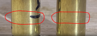

I’ve never seen this before. Just noticed when I was finishing up cleaning my rifle. Could that be sharpie? I did mark the cases for separating which I haven’t done before.

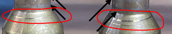

I'm not sure if the comparators would leave that heavy mark on the shoulder and it looks pretty high too close to the neck. Wouldn't the comparator measure closure to the middle of the shoulder?
Just curious are these signs of case head separation? or is it chamber marks?
Maybe you can post a video of the chamber by the neck shoulder junction and towards the base where these lines could be coming from.
I'm wondering if you have high spots in the chamber causing the rub marks on the brass. When the brass expands it grabs the high spots and makes for a heavy bolt lift. I could be wrong, someone with more experience might be able to help on any marks or high spots in the chamber.
Those are from the comparator. Here are 2 pieces of virgin brass. I did the comparator on the one on the right and you can see the line. I spin them around to get them flush.
Have you used go/no go gauges on the chamber???? Those faint marks at the .200 line could be the start of case separation??? Are you having any issues with primer strikes??? What does your shoulder bump gauge show on fired brass for spec versus virgin brass??? Can you check the concentric measurement of the brass at the rear of the case versus virgin brass all the way to the .200 line??? Just to make sure your smith cut your chamber concentric?? Your primers don't show to be pressured and there's not that much of a carbon ring in that barrel to cause a hard bolt lift like you describe. Loaded round is .268 and fired round is .271 so you should be ok on neck clearance. Sized rounds load with no resistance??
stan
No issues with primer strikes, I am not sure on the 200 line this brass has 2 firings on it. I see it on a lot of the brass though. I will have to look closer at some of the other brass put through that rifle. The comparator/bump gauge leaves marks on virgin brass also. I threw a picture up. I am scratching my head. I have a couple barrels on order now. I may just put a pin in this until new barrels come in and run those to see what happens. That way I am not potentially wasting brass.
