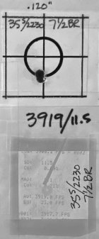

In several 12-14 twists with very short freebore, the 55g Nosler with H335 or Better yet, the AA2230, is printing 3/4" at 300 and flatter shooting than a 220 Swift at 3900 fps. The 60g Sierra HP keeps surprising you with its accuracy, whether using H335 or AA2230, yielding incredible barrel life, Rem 7 1/2s.
