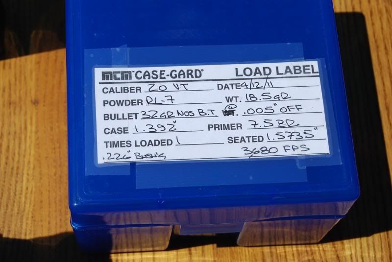

Rick In Oregon : What bullets are you using in your 20 VT ? What bullet velocity near the muzzle ? How about telling about the reloads your rifle likes.. Thanks Them Coopers are fine rifles ...
Here you go, right off the box label on my bench in the field (OAL is a comparator measurement to ogive):
This not a screaming load, but very, very accurate. No need to hotrod this caliber, it does just fine with mid-range loads all the way out to 500 yds.
