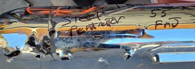

I need to get out to shoot 5,loading up some 55 grain and some of the 62 penetrator bullets shooting them at some metal targets try both see what fps I can get see if those penetrator is worth it, they were cheap 500 $69 I'll try to get 3000 fps see if those penetrator does anything

Should get out Monday morning have more info,got a couple of peices of steel gonna get my fps and more powder for my 55 grain bullets figure if it's better more speed with the 55s or the steel penetrator, leaning towards more speed should have my answers Monday evening I think anything over 3000 fps should work better I'll also take some pictures.

First pic entry second exit 55fmj 25 grains 335 second steel penetrator 62 grain 24.5 grain 335 more speed does the same as the steel penetrator glad they weren't expensive

Ok 62 steel penetrator about 2600 average fps 24 grains no problem loaded 55 grain fmj 25.5 grains shot real good around average 2900 fps pics of an old motorcycle exhaust 55 grain did as good as the 62 grain steel penetrator made a couple of 26 grain 55 grain bullets shot great no pressure problems sitting at 3000 fps much more accurate than the steel penetrator just sounds good glad they weren't expensive.
55gr will penetrate way more. That tiny little steel tip inside doesn't do anything. SPEED is what you want, especially in this bullet.
Yep got around 3000 fps blew right through my old motorcycle pipe 55 fmj and 62 steel penetrator the pictures first pic entry second exit

Yep after doing a few tests loading max or close to max using 55 grain jacketed work just as good as steel penetrator bullets glad they were cheap
