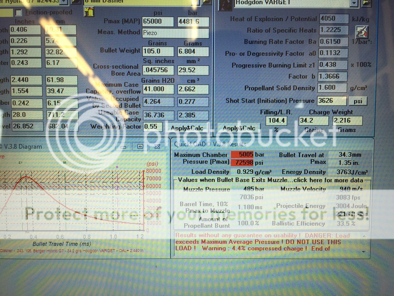

What are you guys calling pressure signs?? No disrespect meant to anyone here, but I understand what increasing freebore does to pressure and case capacity. Not calling anyone out or a lair, but I've NEVER seen a prime pocket stay tight pass 6 or 7 firings running a medium load, much less 34+ grains..In my experience, the two just don't go together...and my experience is I've shoot out 11 Dasher barrels in the past 8 years, so I do have experience in this matter.
I've running a .124 freebore...so when you look the the picture that I'm posting, note the the AOL is 2.440..I arrived at that number by taking one of my loaded rounds that is just touching the lands..that measures 2.410 with my .124 freebore and a hybrid bullet. I added .030 to that number to make it a .155 freebore that all you guys are talking about using. Please take note of the pressures that you are running...and that is at 70F....So, I feel that coming on here and telling guys that have never messed with a Dasher that it's safe to run 34+ grains is unsafe..but to each his own..
Try with 41.48 gr. This is what my case capacity it closer to (just weighed it with H20).
All I can tell you is that on my second firing, primer pockets feel fine. There are no signs of pressure that I can see when inspecting the brass post fire. Primers look normal. No cratering. No heavy bolt lift. I also ran 12 consecutive rounds and never felt anything different or saw anything different in the brass or in the firing process or in the brass from shot 1 to shot 12.
I know quickload is a good program to determine this kind of stuff, but I am sure there are some variables that are just slightly off in your calculations. I just do not know what to say. I have talked to a few other people not on the forum and I highly respect their opinion and experience and what I am doing is not out of the norm either. Yes, I am probably VERY close to max pressure. Could be there is something a little different about my set up that is resulting in less pressure?

So..couple of things I need to admit here...I was using a .104 freebore, and then switched to a .124. I don't think I can attribute the 100fps different to freebore, but it might play a small role...I'm convinced that the Varget we are getting today is a much slower powder than Varget of the past. This would also help explain the huge disparity in velocity sand pressure that I'm seeing on Quickloads as well..going out tomorrow and work g my way up to 34 grs..I know these guns shoot very well around 3040 range..

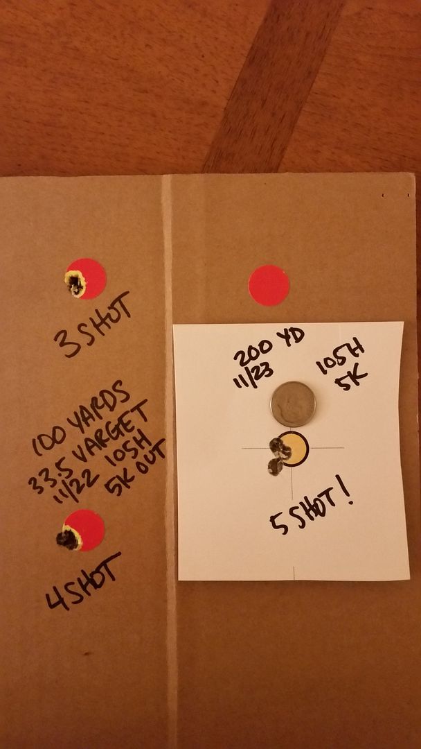

I then decided to break in the other barrel I had chambered up. Took it to the range and did a little more rigorous break in process: 1-clean-2-clean-3-clean-3-clean. After this, it started to shoot a "standard" 33gr Varget load into around a 3/8" round group, so I decided to start the load development process. I had rounds from 32.8-33.8gr Varget, loaded about 5K out. I have a .155 FB by the way. I am using 105 hybrids, CCI450 primers.
As I worked up to 33.4, the groups started to tighten. 33.4-33.6gr produced a similar POA/POI shift and producing high 2's for 3-shot groups. After 33.6, the groups also started to open just slightly, but most importantly the POI was changing slightly so that indicated to me that I was moving out of the node. I went home and loaded up 33.4, 33.5, and 33.6 grains @ 5K out and cleaned the barrel well and went back out in the afternoon. Groups shot even better @ just around the 2's for all three powder charges (I didn't measure them but they were good). I chronographed the 33.5gr load that I used for foulers and was getting 3011 fps (right in the sweet spot) and 15 ES for 3 shots. Decided this was the node and went home, cleaned the barrel again and loaded up some rounds @ 33.5 gr with different seating depths.
The next weekend I went and shot some foulers and then started to shoot for groups. 5K out was good, but as I approached 10K out, the groups shrunk into the high 1's. I thought to myself...GREAT!!!!! Shot the rest of the loads and noticed that the seating depth range it would like is around 8-10K out. Again, went home and ate lunch, and did not clean the barrel, having only shot about 15-20 rounds in the AM. I loaded 15 rounds at 33.5gr Varget, seated 8K out. Shot 3 foulers, which both went into one hole and then shot a 3 shot and 4 shot group. The results are below at the red dots. Thought to myself, I got the load down! I chronographed 5 shots and ES was around 14 ES. Not bad!
The next day, I decided to stretch its legs as far as I could at my local range, which is only 200 yards. Loaded up the same loads and with a clean barrel, shot some foulers to get my 200 zero and then shot a 5 shot group. This was the first group shot at 200 yards (in white). If I remember correctly, it was a .57" edge-to-edge group, meaning a .15 MOA group. ::) I chronographed 3 more shots after shooting a couple more similar, but slightly bigger (.22 MOA and .27 MOA, 5-shot groups), and I was now getting 3058 fps with 13ES. My barrel was sped up from the last time I went out. Hopefully thats the end of the speeding up. In 50-60 rounds, I had a load developed and am ready for the 2016 mid-range shooting season!
