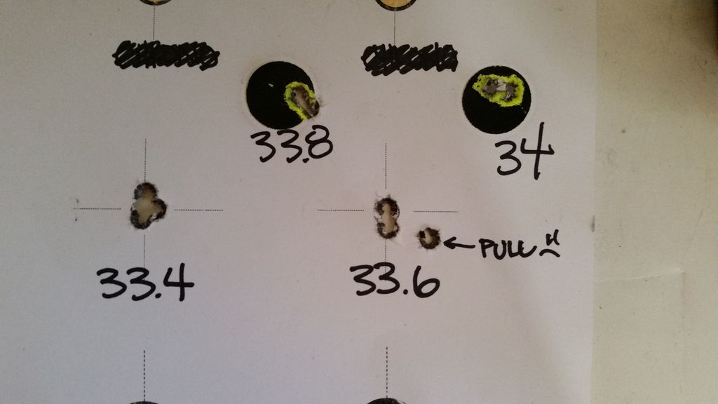

So I took out the gun with formed brass. 100 yards. again, slightly heavy mirage. I tried one round at 34.5 grains and no pressure signs.
Still the same thing...Varget with 105gr hybrids loaded 20K out with a .155 FB.
Over a 0.6gr spread, I had great results. 1 group had a pull. I am thinking of trying right in the middle of this, at 33.7gr. best group at 33.8gr @ 0.166 MOA. I did not show 33 or 33.2gr but it was bad and looks like it is out of the accuracy node. these are 3-shot groups
charge ave ES
33.4 - 3031.5 - 15 fps
33.6 - 3042.5 - 7 fps
33.8 - 3072.5 - 5 fps
34 - 3087.5 - 4 fps
Notice how your vertical and ES is getting better as you go up. If you have no pressure signs at 34 I'd stay there and test at a further distance.
