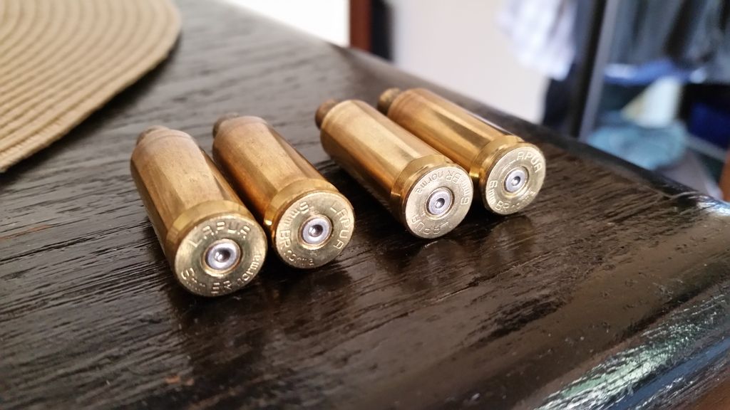

Here is a pic of the primers. Left is the false shoulder. Right is the hydroformed brass:
Here is a pic of the fired brass. Left is the false shoulder. Right is the hydroformed brass. I noticed the false shoulder brass are still slightly rounded while the hydroformed brass were pretty sharp.

* I have some concerns for the blow lengths. a 0.020" spread seems concerning to me. Should I be?
