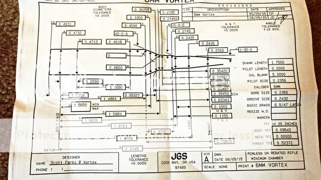

JGS emailed me today saying that someone was inquiring about the reamer/print and asked me if I was OK with releasing it to the public. Which I thought was pretty nice of them to check with me. I said absolutely. So you should be able to just call JGS and have a 6mm Vortex reamer made off the print.
Re: 6-6.5x47 Ackley Dashtex Long
Darn, somebody came on here and saw our conversation about it.. I'm going to inquire about the reamer specs and case dimensions and see if that's what I'm describing.. It should be just like the 6mm SMACK...

I have the reamer print, but Ive never posted pics on here and I dont have a photo hosting account anywhere. Shoot me a PM with your phone number or email and I'll text or email it to you.
