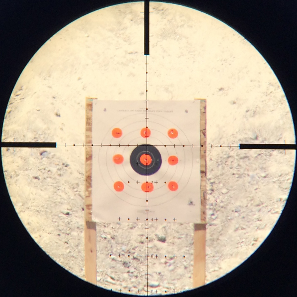

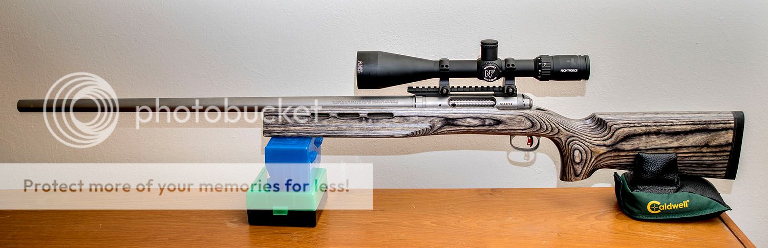

Here's my new Savage model 12 Benchrest in 6.5-284.

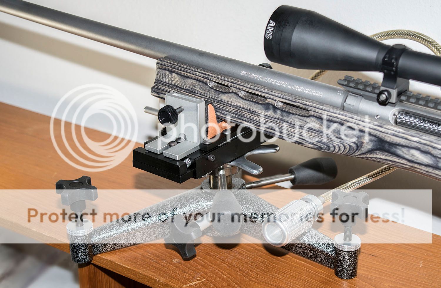

It's wearing a NightForce SHV 5-20X56X30mm in titanium rings. Shot it yesterday to roughly get the scope adjusted, but tomorrow at Ben Avery will be its 'serious' debut. Also have a new Bald Eagle rest...
...to 'break-in'.
Am taking 18 different loads to shoot.

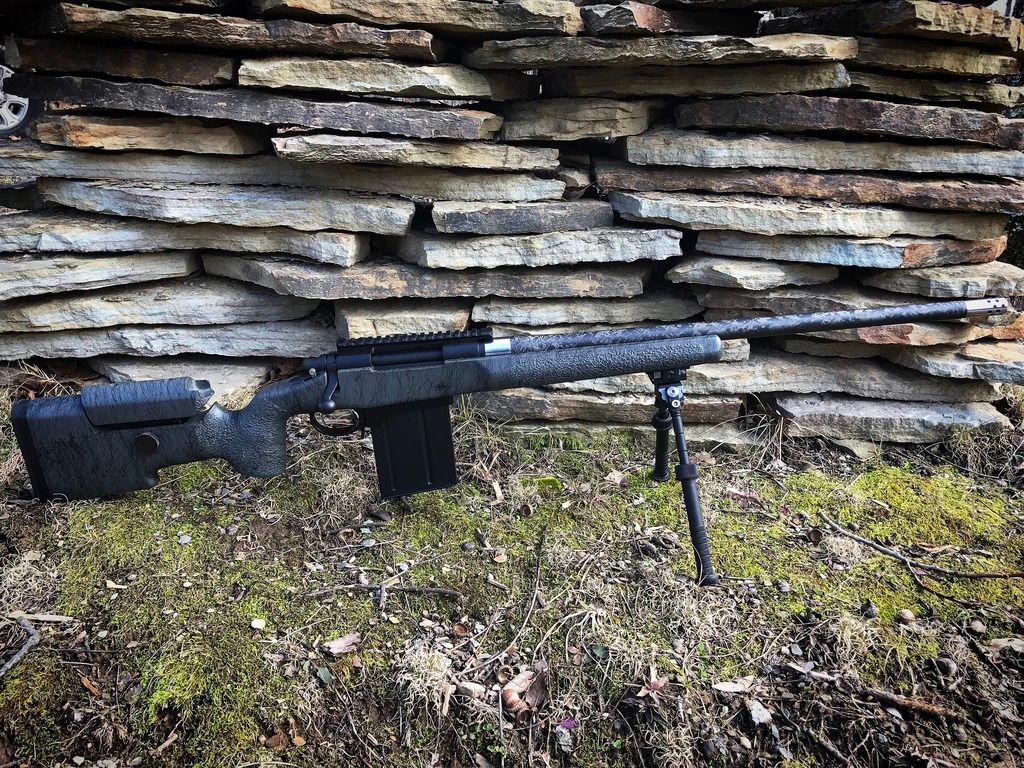

Here's a PRS rifle in 6.5x47 I finished up for a customer last week. It has a Defiance Deviant, Manners T2A w dbm chassis, Bartlein Barrel, Jewell Trigger, Round Mini Magnum "Muscle" brake, Spuhr mount, and Vortex Gen II Razor. 16 lbs w optics.

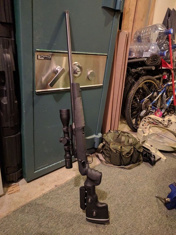

Here's my low budget Savage 10 6.5 Creedmoor build for hunting primarily. Green Mountain blank done by Apache, PTG nut and lug. GRS Berserk stock. I hope to get trigger time tomorrow with the rifle. Other than the barrel, stock, it's basically a stock "rescue" savage I got for $270 as a .308win.

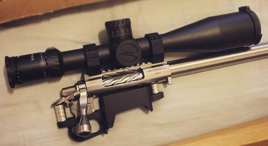

Here is my 6.5-47 Lapua
Defiance deviant
PRT F open lowboy
30" Krieger 1.250 straight 8 twist
Jewell BR
vortex golden eagle
Haven't got to shoot it much, 140 hybrids show good results, I got some new vapor trail's this weekend so will be trying them.

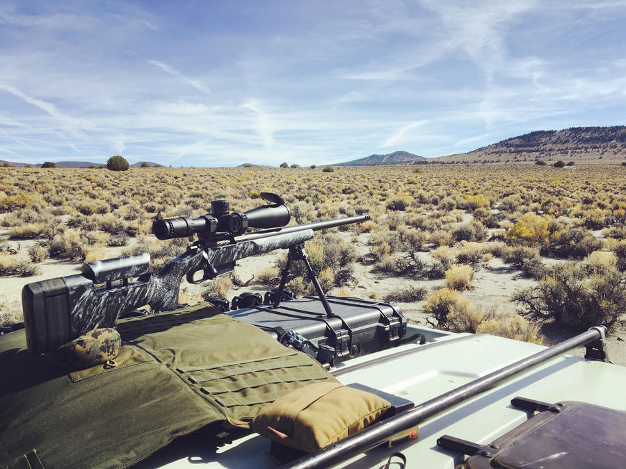

Heres a 6.5 saum I did for a customer. It has a Stiller tac30 action, Manners EH1A folding dbm chassis stock, Brux rem varm 24" barrel, Timney calvin elite trigger, Vortex Gen II razor, and Hawkins precision scope rings. He just sent me this 5 shot 2.25" group @984 yards yesterday.

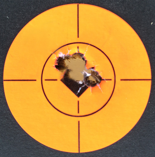

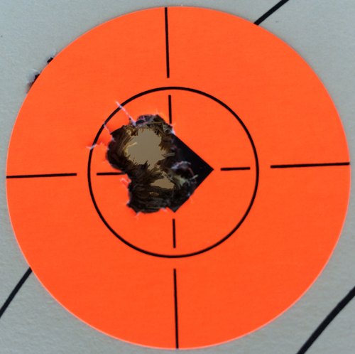

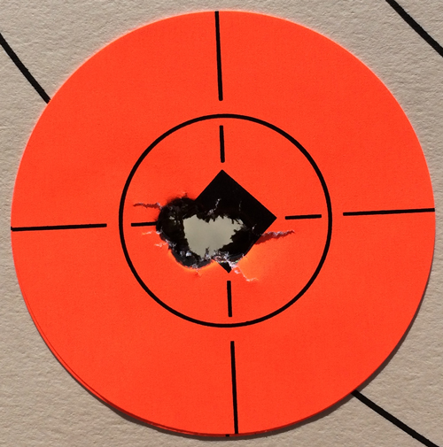

3 shots @ 100 yards with 48 gr RL26, 143ELD-X, 2999 fps and 5 shots @ 100 yards with 43 gr H4350 140 RDF, 2839 fps .391" ctc
