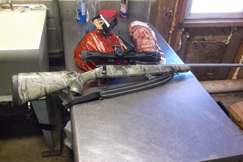

This rifle started life as an old 6mm Rem. The barrel was getting tired and so I decided that it was time for a change. I bought a 24-inch, 1/8 twist, Rem-age .260 barrel and had a buddy screw it on and bed it for me.
The scope is an SWFA 10x SS in SWFA rings.
It shoots 1/4-1/2 moa at 200 with 129-grain Interlocks over Re17 @ 3010 fps.
10 pounds of a deer's worst nightmare!;)

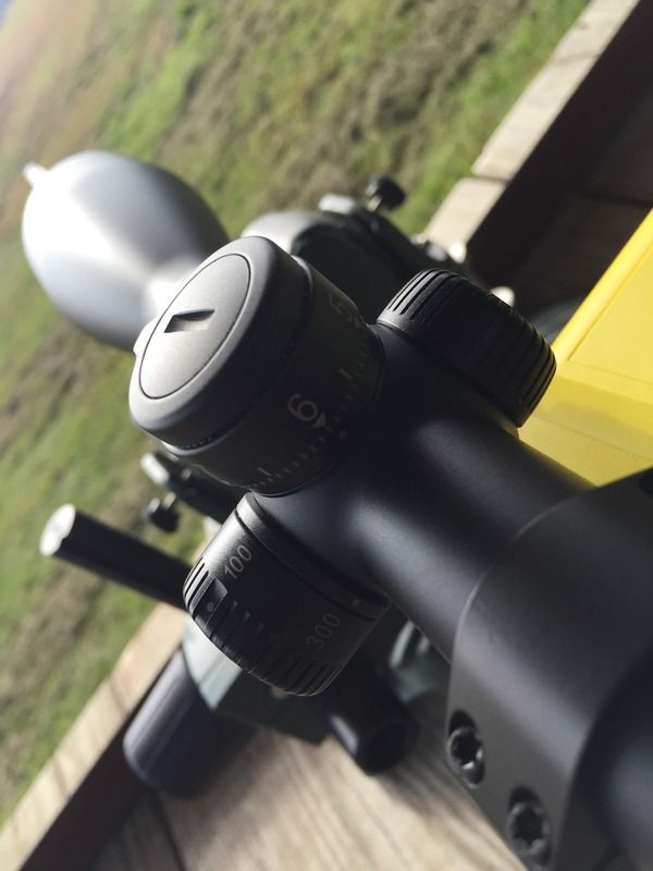

6,5x47 Lapua
Remington 700 action
Jewell trigger
Bergara stainless barrel 27"
AICS AT Stage II. folding stock
Nightforce 20MOA rail, ERA-TAC one piece mount
March FX 5-40x56 FFP scope

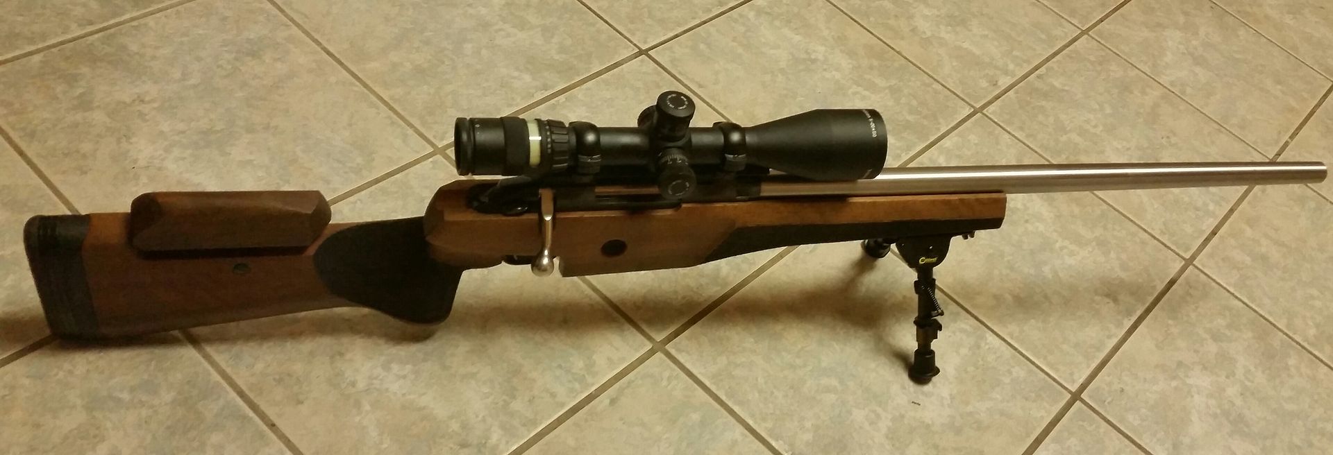

My 'trans-gendered' rifle - as a friend named it. Started out as a 'rescue' 30-06 with tupperware stock. Sent it to Pac-nor and it came back as a 6.5 Swede. Shot some Lapua factory 123 gr Scenars and got a .441" group. Then loaded some 142 ABLR and it did this:

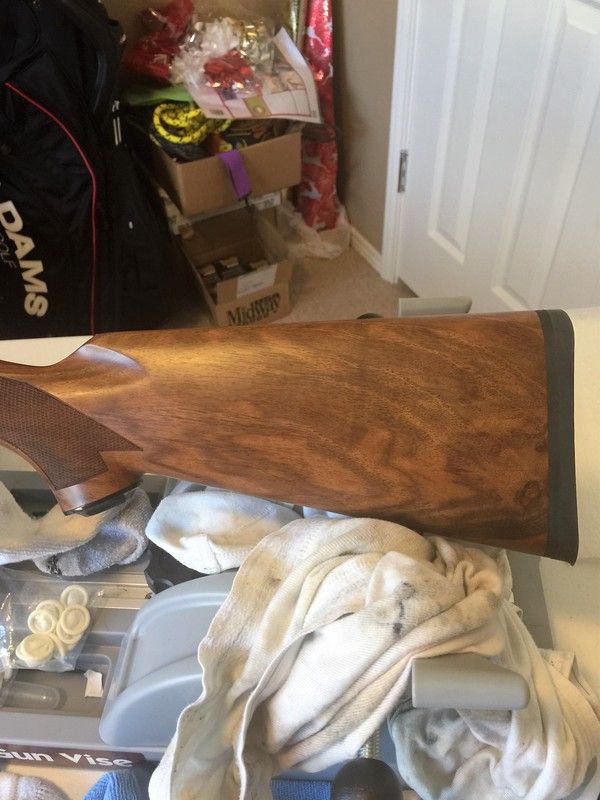

Found a stock online and it's now all pretty and looks like this:

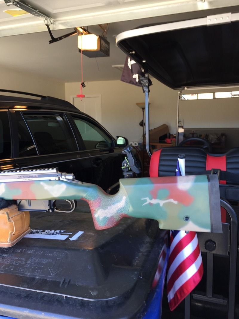

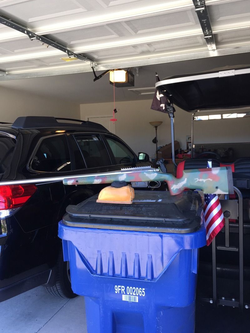

Here's a 6.5 saum 4S I just finished up for a customer. It has a Stiller Tac 30, Manners EH1 gap camo stock, Brux #4 straight fluting barrel, Curtis Custom bottom metal, Accurate 3 round mag, Jewell trigger, and my 9/16x24 PR brake.

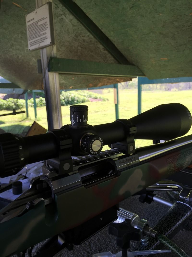

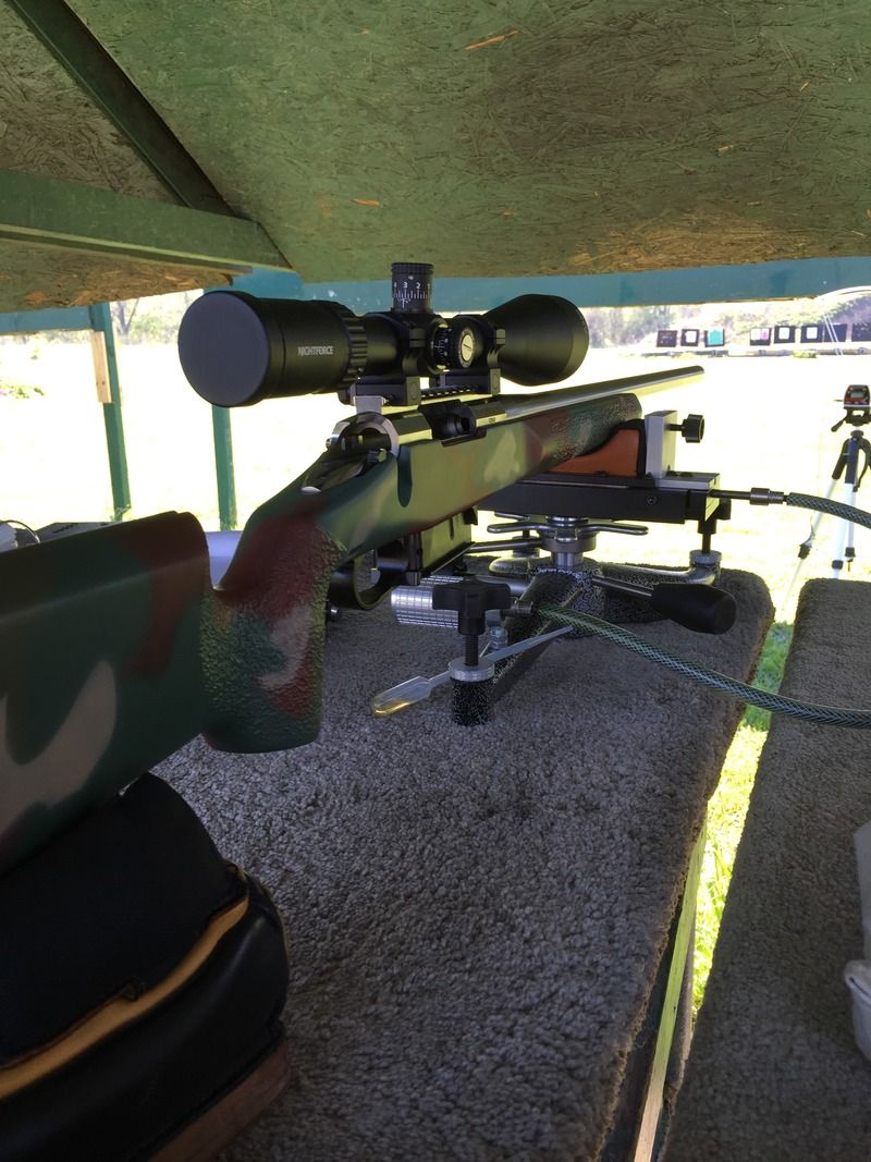

Will Fairbanks built 6.5 Creedmoor, F-Class and 400yd clay matches, Defiance action, Jewell Trigger McMillan A-5, Bartlien 1X8,

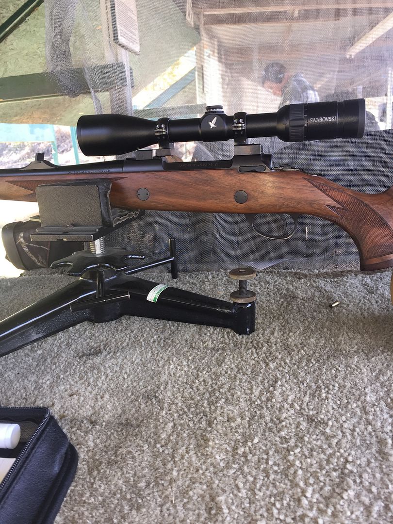

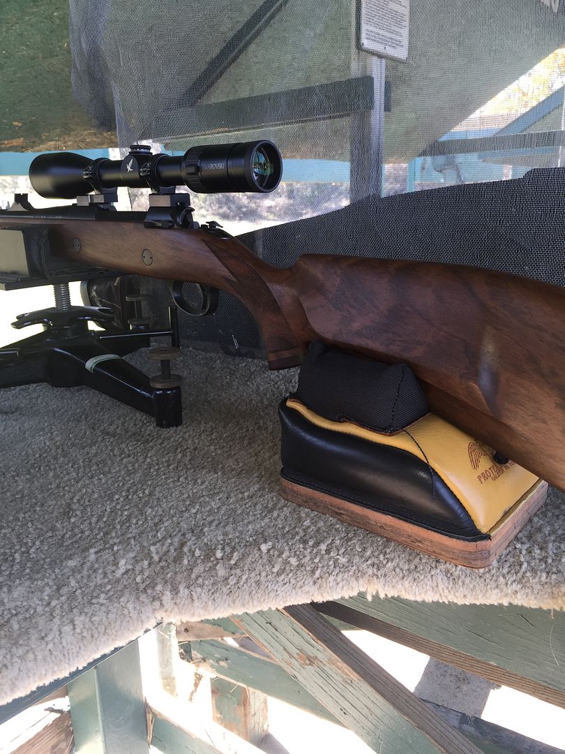

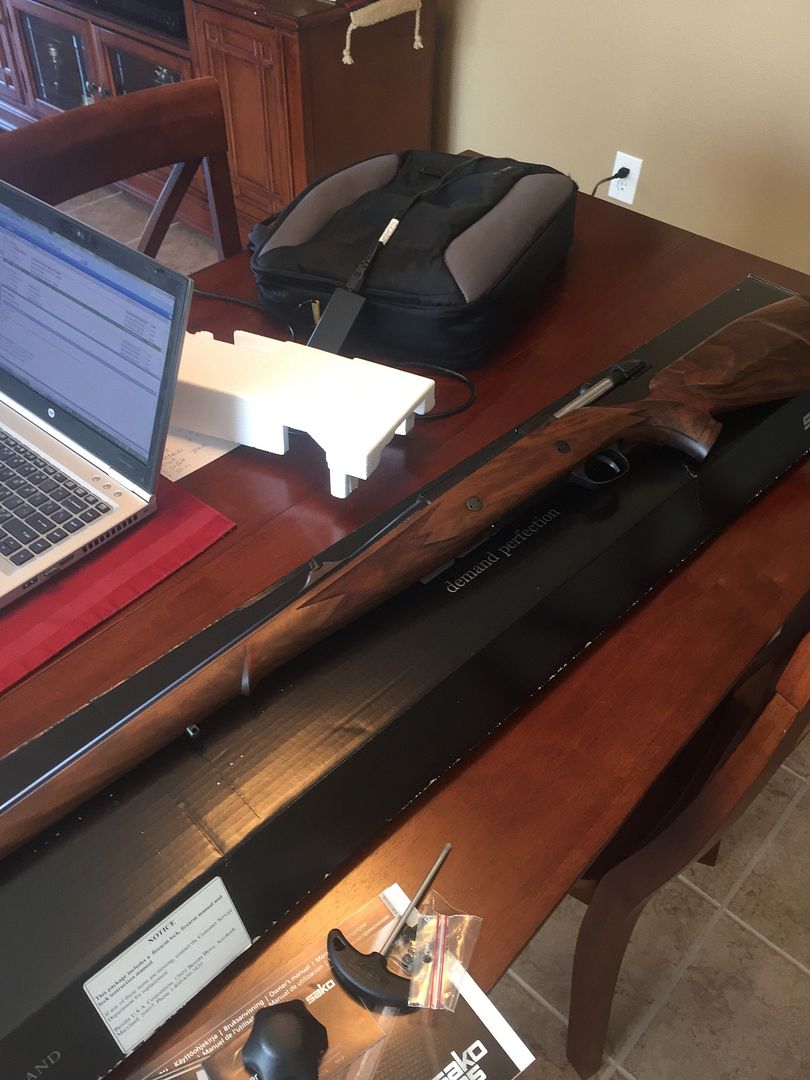

Sako Bavarian Carbine 6.5X55 Swede Swaro Z-3, 3-10

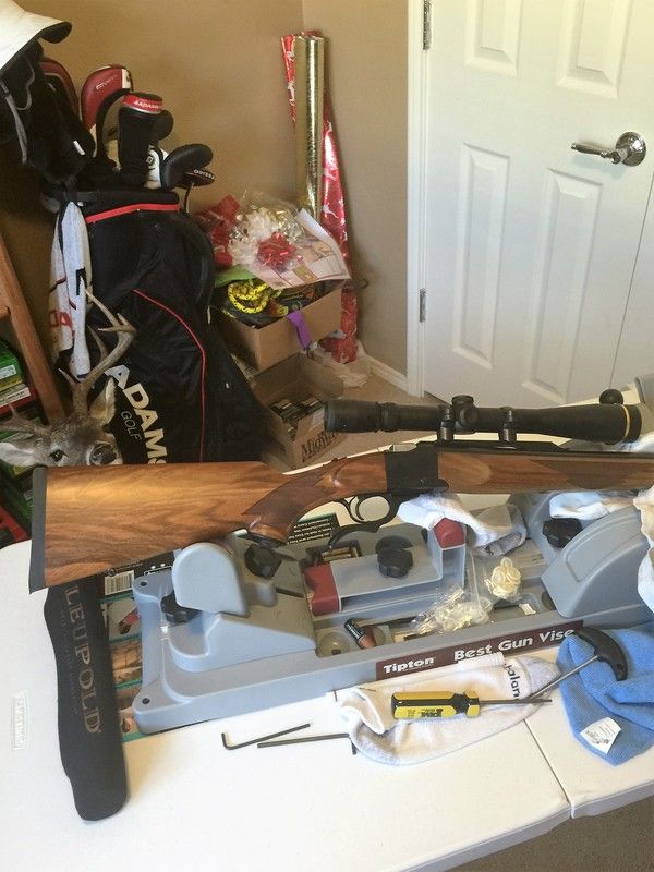

Ruger #1 28" 6.5 Creedmoor, discontinued
