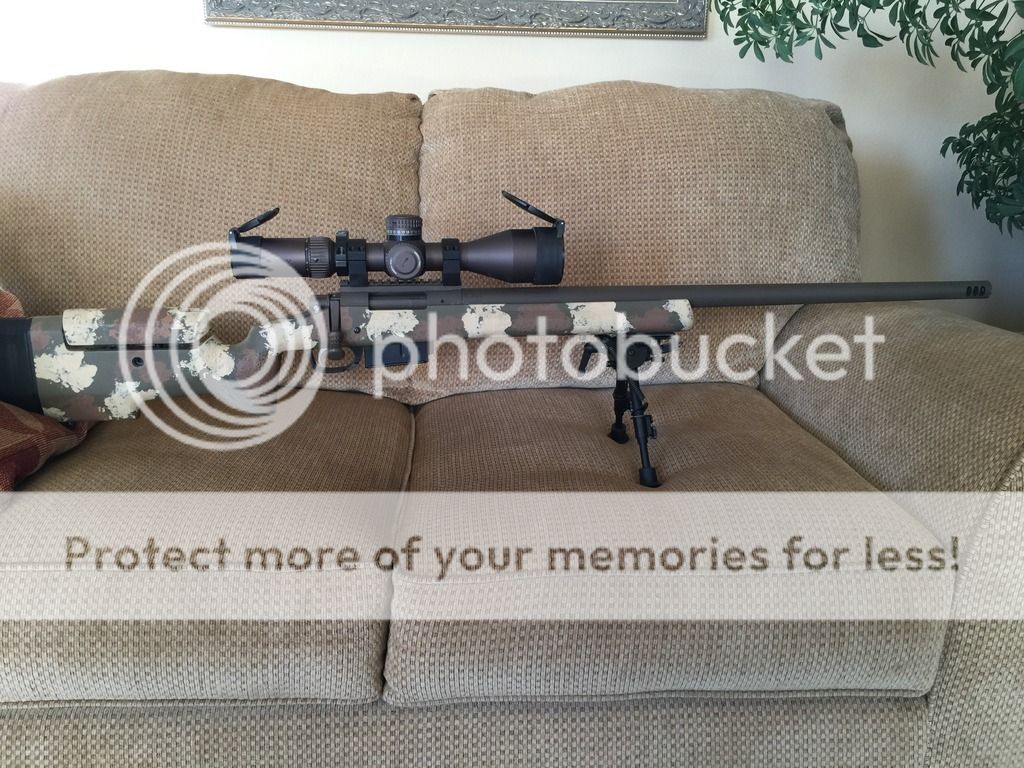

Pic 1. 140 gn Berger Target Hybrid 3 shots at 100 yards
Pic 2. Same load, 3 shots at 800 yards.
Pic 3. Remington SA. Trued by SnS
Rock Creek M24, 8 twist.
B&C Medalist.
Vortex Razor HD Gen II.
GoneshootinginAZ.
Thank you! I call her Frankenstein
Hornady brass, BR2, 42.4 of H4350.
About 2760 fps.
I use a Redding body Die, Lee Collet Die and LE Wilson
Chamber type seater.
The paper group was neck sized 3 Xs.

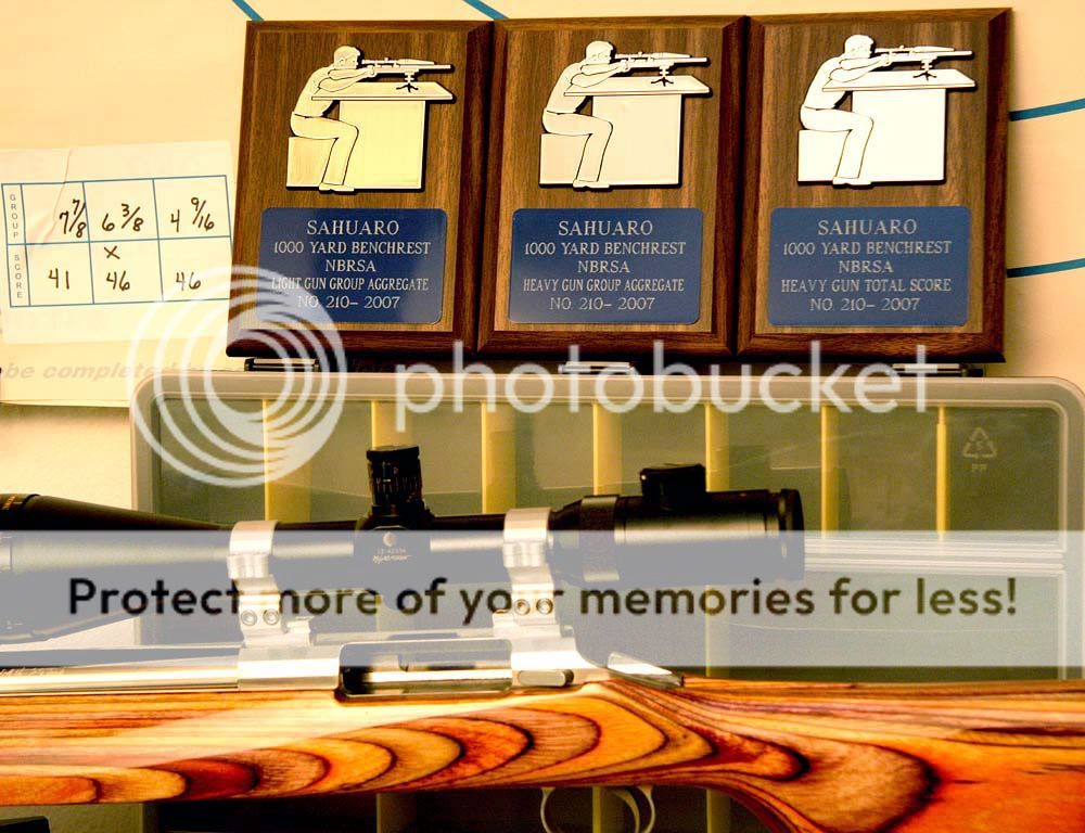

Here's an oldy but goody and a new one.
2006-7 1000yd-BR Light rifle. Built by Bill Shehane in 6.5-284Shehane with a BAT-B, Bartlien (IIRC) 28"er, Shehane Tracker II (IIRC) stock, Nightforce 12-42X56.
Shot it really well one WE at Tres Pinos, w. of Tucson, winning three of four trophies. I'm particularly proud of the 4-9/16" 5-shot group. :) Also shot a 7-odd-inch 10-shot group.
