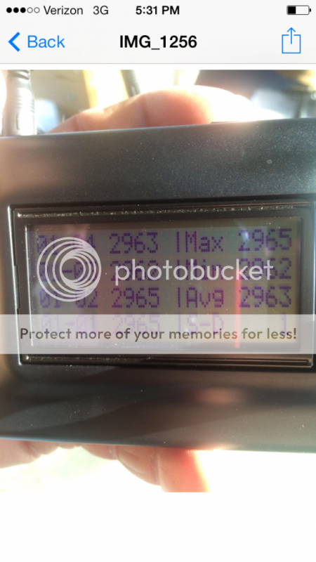

I can get the high speeds with my 28 inch barrel with 140 Hybirds but if I want accuracy 2750 is where I am at,,I was shooting today and was shooting 2 1/2 and 3 inch groups at 800 yards with the 140 with 36.2 grs IMR 4166 at 2740 with SD of less than 10,
I can get good accuracy with 123 Scenar and 42.7 H4350 with pretty good chronie results also,,
pic of magnetospeed with 123/H4350 load
