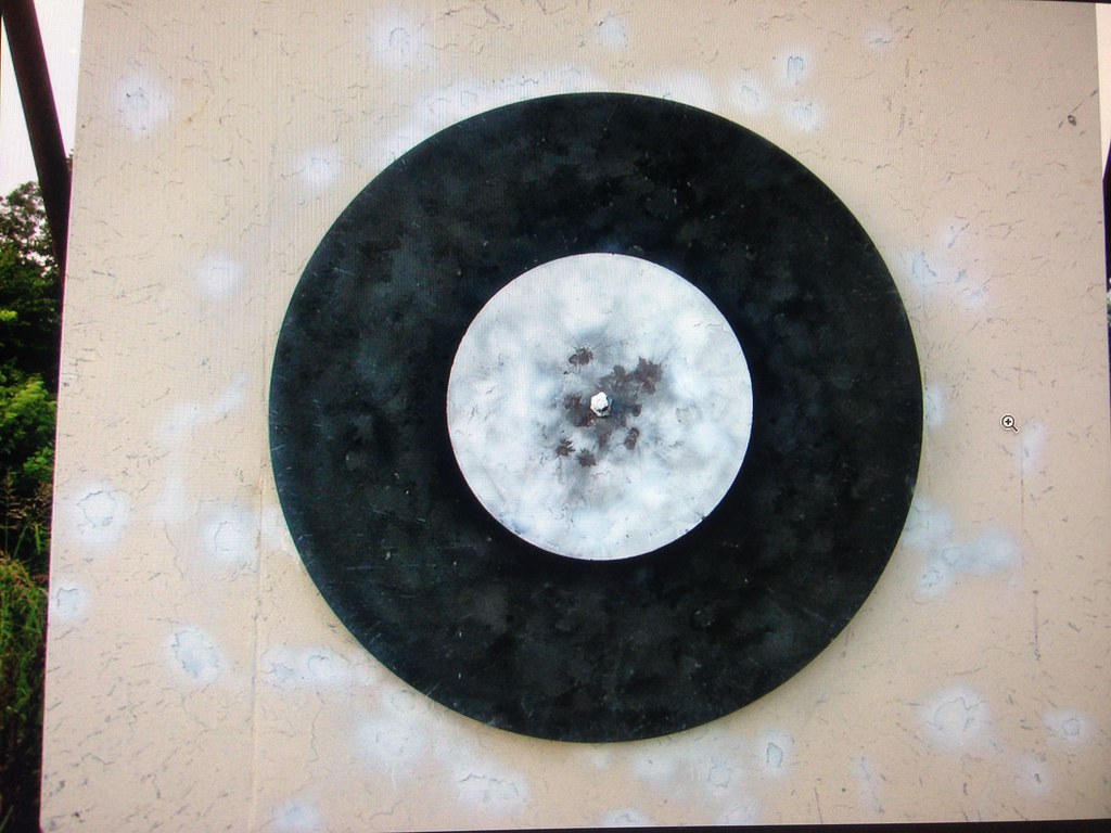

This is all I need to know about the 6.5 x 47 Lapua: This is the first 15 shots I fired with this rifle when I got it from Jon Beanland. Range 1000 yards. The white plate is
20" diameter. The nut that holds the plate on the tgt frame was hit so many times the plate fell off. This is the same target size as the Wimbledon Match is shot on at Camp Perry.
15shot by Sharps Man, on Flickr
