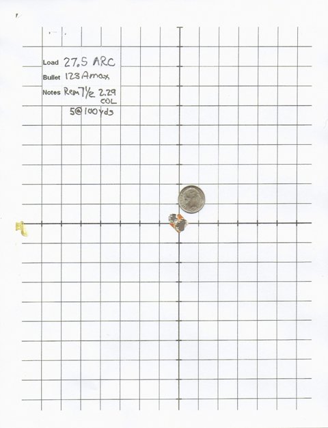

I have a Howa 1500 mini action. I like it but don't like the way the magazine sticks out. You can do mods on the magazine and the trigger. I bought a HB from Brownells and put it in a Boyd's AT-1 stock. After the season I will probably pillar and action bed it. The trigger is ok but can be better hence the mods. I can get around 1/2" groups with it. As Hoot says don't discount the Grendel in an AR Platform. I put together a BHW Barrel 20" with a 1-8 twist that shoots just like Hoots picture. It is very accurate with 123 ELD M and 85 gr Sierra HP. Only thing I shot last yr was a bobcat and it was DRT. I like the Grendel round quite a bit. Go to www.65grendel.com. You can get some ideals there.
Did you have fits getting your BHW barrel to shoot like That? I got one for my wife. I tried a ton of loads. Then it happened. I shot one round nice, fired again him. Where did it go. Fires again nothing. Fired again nothing. Got miffed and pulled the target in disgust. Then took a close look and realized all five shots were in the same hole.
Oh it was a 6 Grendel .
