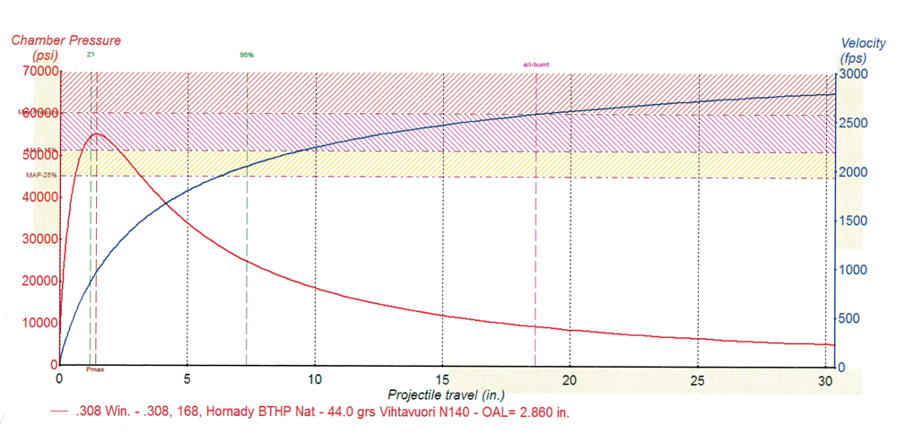

A lot of people are shooting 32 inch barrels in FTR for the reasons depicted in that chart. Basically the powder burns rapidly, building pressure rapidly and dropping off rapidly a first and then more gradually as the bullet makes its way to the muzzle. However, as long as the pressure is high enough to overcome the friction of the bullet against the interior of the barrel and the atmospheric pressure, increasing acceleration will be the result. It would take a very long barrel for the pressure to drop low enough for the bullet speed to drop below it's peak velocity prior to exit from the barrel. These are the physics of the sport we are engaged in. If someone claims to have experiments which run counter to these physics, I'd speculate that there is something wrong with their experiment.
That aside, I'm getting about 2800 fps using H4350 from a 28 inch barrel with Berger 140 hybrids. I've tried higher and lower charges which yield increased and decreased velocities but 40.9 gives me the best accuracy at an acceptable velocity.
I agree, except for one small item: Acceleration is never increasing here, it is decreasing constantly. The acceleration (instantaneous positive slope of the velocity curve) is greatest immediately after the bullet starts moving. By 26 inches down bore, acceleration is slight.
But that detail aside, I agree your graph shows acceleration even at 30 inches in the example 308 Win load. The key question is at what distance down the bore does a 142-gr bullet stop accelerating ahead of a max charge of H4350 in 6.5 Creedmoor? Can you plot that?
That is not correct. The "rate" of acceleration decreases over time/distance. The bullet however continues to accelerate. Between 25 and 30 inches it accelerates an additional 50-150 fps. The bullet never decelerates while in the barrel. It would take a very long barrel for that to happen.

We are saying the same thing. What you said that I disagreed with was (emphasis added):
"as long as the pressure is high enough to overcome the friction of the bullet against the interior of the barrel and the atmospheric pressure, increasing acceleration will be the result".
Yes, the bullet is still accelerating, but acceleration is not increasing! It is actually decreasing (while velocity is still slightly increasing.) You could have said " ... increasing velocity will result ...".

Yes, you are correct. We are saying the same thing. The bullet continues to accelerate (albeit at a lower rate) which means that velocity continues to increase (also at a lower rate). I've seen that article which purports to say that a longer barrel results in reduced velocity. That would not be possible until the barrel exceeded any reasonable expectation of what a barrel should be be.
