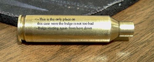

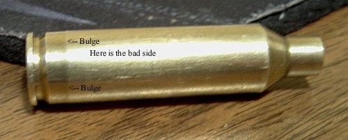

Are you sure that it is not just the offset buldge which happens when your brass is a few thou undersized to your chamber. The head is solid brass so it won't expand,at normal load pressure anyway) so the budge starts at the web. When your un-fire but formed,without a false shoulder) case is in the chamber, it rests on the bottom of it,gravity), and when you fire it, it expands to fill the chamber. As it's already against the bottom of the chamber wall, it has no where to expand there so you get the buldge everywhere else around it.
Good side of 6XC formed without false shoulder
Bad Side of 6XC formed without false shoulder, approx. 3 thou bigger in said area than good side
