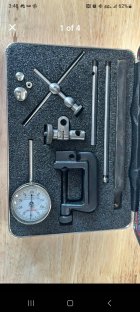

He also offered me a starrett dial indicator. Can this be used to measure neck concentricity?
