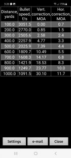

I plugged numbers in for some (6mm) 87gr and 90gr bullets running around 3200 fps, and there wasn't 2" difference with what I'd get with a 223 and a 75gr at 700 yds. That said, it seems like with 6mm cartridges (6br, 6xc, 6x47) its a a LOT easier to find multiple loads that are tack drivers where as with a .223 its more of a challenge to find a really accurate load that will push a 75gr ELD in the 3000 fps range. Even at 500 yds, a gun that shoots MOA from a solid bench rest isn't going to cut it even on a calm day. The only experience I have with cartridges like these is my 6.5 Grendel. It has been the easiest cartridge I've ever loaded for, and my assumption is that the 6BR, 6 Dasher, and 6XC would be similar in that regard. I feel like my chances of eventually rebarreling my Savage and ending up with another 1/4 moa 75gr load is a roll of the dice at best. The accuracy potential is probably the thing that interests me most about these recommendations. Realistically, knowing that the 6xc is a proven performer even at 1k is enough for me to want one whether it ever draws blood or not :)
Run a 75 ELDM at 3350
87 VMAX at 3200
75 ELDM at 3350

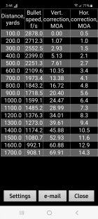

6 Dasher at 3050 with Hornady 108 ELDx at one mile.
Just for grins I did a 6mm 75 VMAX at 3350 fps.
Compare to 75 ELDM in 22 at 3350.
I ran those also. Basically a 22-250 would be about 9" less drop at 700 yds, but would have about 2" more drift than a 105gr from a 6xc. If I dropped the 6xc down to a 90gr, then I can nearly duplicate it with a 75gr eld from a 223 with a 26" barrel which is what my Savage has. There's literally no measurable difference except that the 6xc is probably easier to load for with regards to accuracy. I still want one, but this has really made me stop and consider what benefit I'm getting for the time and money invested. Oddly enough, when I search for load/velocity info for various 22 cartridges and a 75gr bullet, I have to step up to a noticeably bigger cace to be able to push the 75 or 80gr noticeably faster than I can with my 223 Savage, which means I'd be looking at a barrel burner. Basically, an accurate heavy 26" 223 barrel with a 75gr eld is hard to beat by a significant amount without sacrificing a lot of barrel life.
