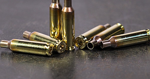

I would not base my choice on Lapua brass availability. I just wouldn't. Too sketchy. Tubb is $82 per 100. Either small or large primer.

Grafs was showing 6x47 and 6xc for about the same price, but $82 from Tubb is a MUCH better price! I'd likely try to buy around 400 pcs of brass. Spending over $500 just on brass is a painful thought. Spending over $300 is also painful, but it seems like it would only hurt about half as much :)
