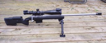

Finished the final touches this morning. It is officially a working gun. Unfortunately it's too crappy outside for the Chrono to get a reading but I can tell you that 70 grains and 75 grains of h1000 were no problem...cases extracted fine with no pressure signs and very little recoil. Final weight is 18 lbs
Okay, got a sunny morning had to change powders but I did hit 2700 with 7828ssc , then 2800 with imr4350....
Max load with h1000 was 77 grains at 2693 fps(that was using a drop tube and loaded all the way to the base of the neck). no dangerous pressure signs with any load, primer pockets are still good about three firings each on three cases. Resize is stiff but manageable.
