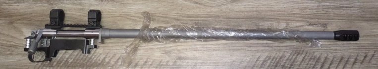

I am currently in the process of building something like this. My gun is a 338 win mag match chamber made to my specs. Pacnor 28.00"x 1:10x .950" heavy barrel, kahntrol brake threaded 3/4-24, remage nut, rem 700 trued action, Jewell hvr trigg, near 25 moa base, heavy badger USMC rings, tighter tolerance ptg bolt, Burris xtr5-25x50 non illum scope. C o a l will fit an AI mag with about .100" room to spare. Already weighs 14 lb, should weigh about 20 when I'm done. Have not picked out stock or bipod yet. Waiting for Santa Claus
