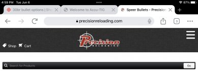

125s in stock at “Precision Reloading”. I’ve never bought from them so be careful! Use the search thingy here for reviews and more good info.IMG_0145.jpegIMG_0144.jpegIMG_0147.pngIMG_0146.png

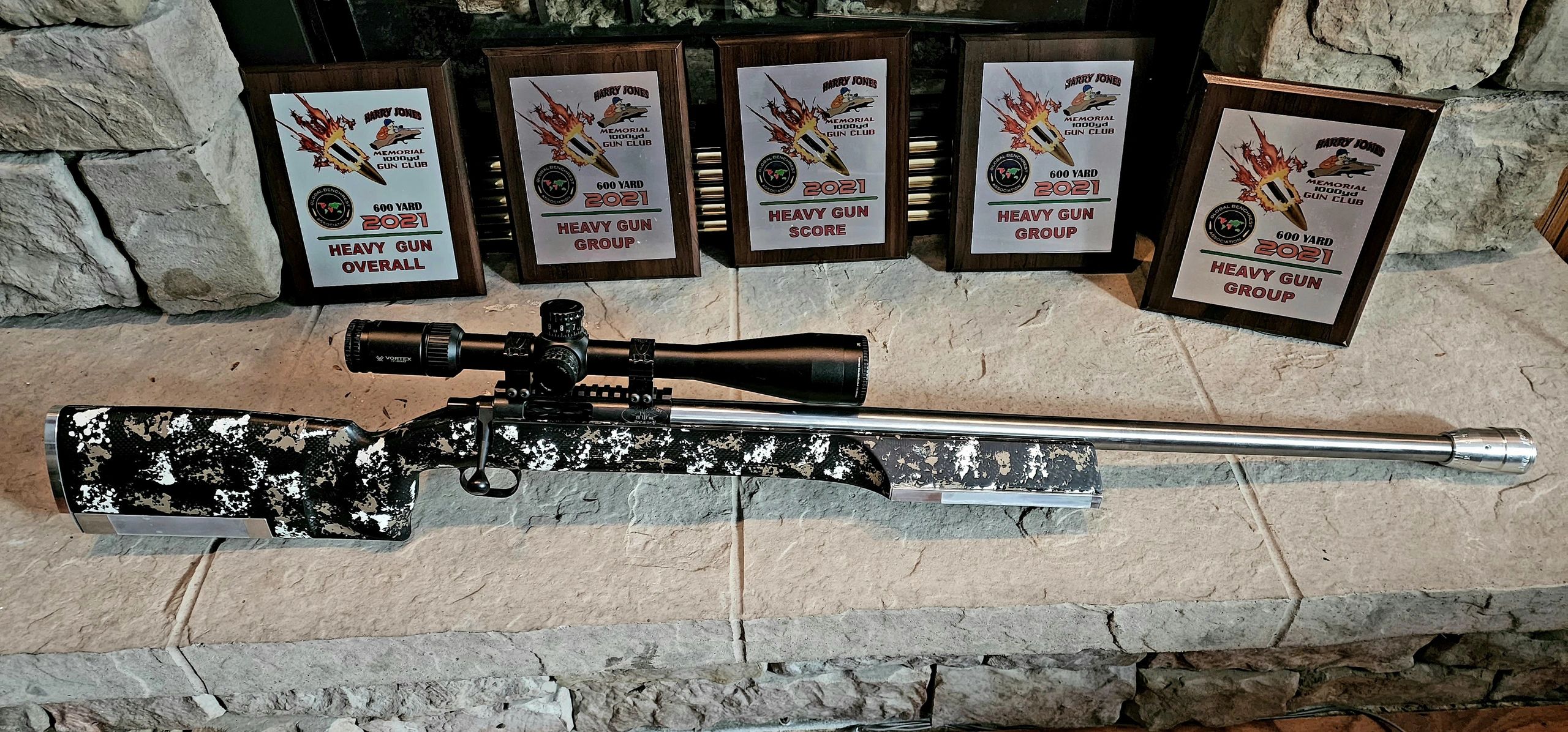

The 125 gr. TNT does well for a factory bullet. Jcline here on the site makes some great bullets. I think he is doing 112 118 and 125 gr. as well. My 700 BR 1 - 17 Tw. has shot my record group ( .010 ) so far with Bibs 118 gr. Danzac coated bullets with 34.2 gr. H-4198 @ .012 jam.

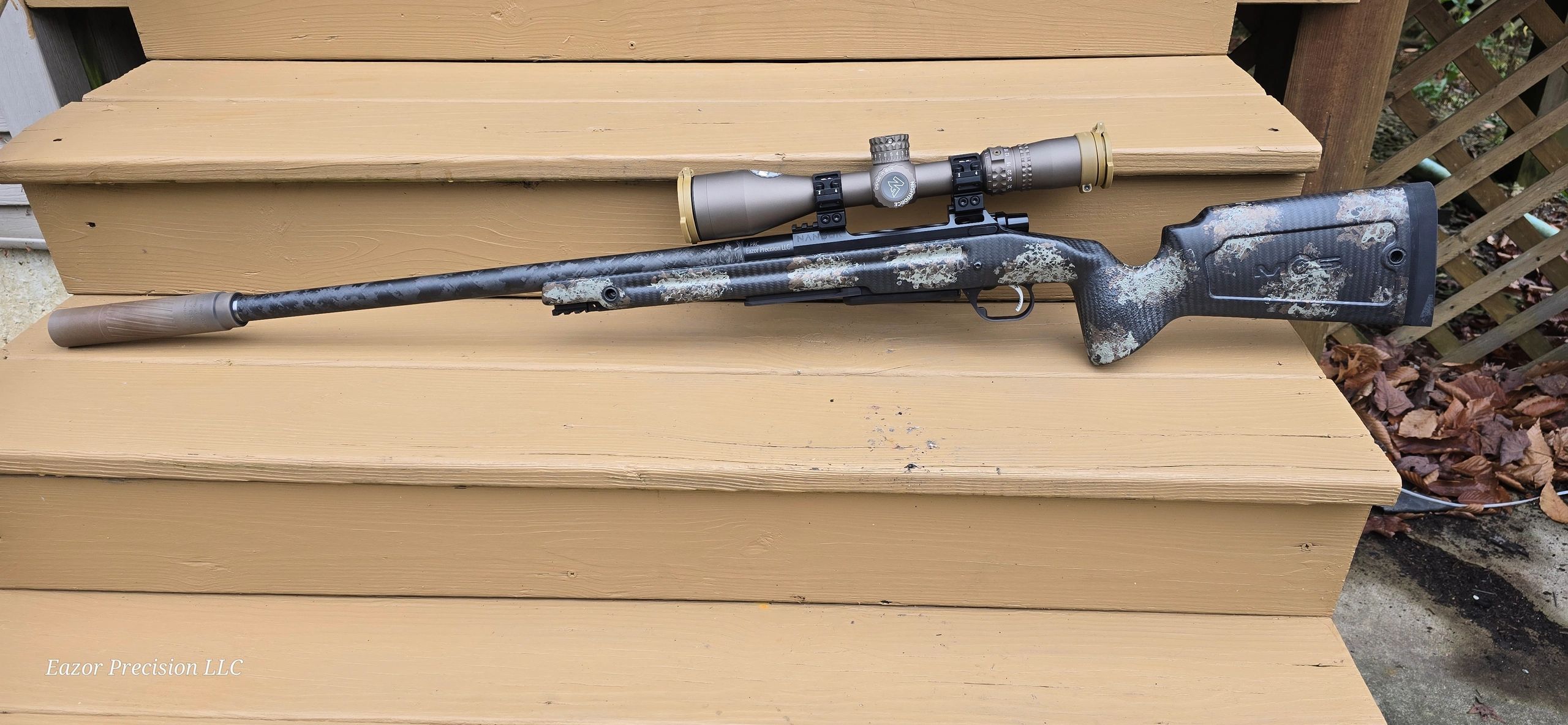

You might try Jamie Eazor at Eazor Precision. He makes a 118 grain on 1" jackets that's quite good. I was on Randy's wait list one year and tried the Eazor's instead. They're about a 9 ogive vs. Robinette's 10 but I never saw a difference on target or scores over the year.
