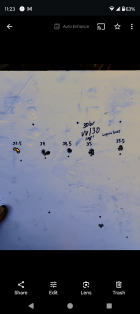

This is my first eight shots after two sighters to get on paper. Im kinda floored. Very pleased. These are Cline's 108s , alpha brass, neck turned. Shooting 35g of Vv133. Seated at jam. Bullet length was 2.275..
Anyway, very pleased so far with things. I had to bed my stock, put pillars in and piece together myself some scope mounts. Action is a Neskia J chambered by RoyinNC. He did a dam good job
Very nice. Looks like it wants to shoot for you.
My intention was to see if my scope would zero. I only made up 10 rds. And 133 was the fastest powder I got on hand at the moment. 35g seems like that's all shel hold. These bullets too, they seem super consistent. They all measure the same, ojive wise right down to the thousandths..

Those groups measured .26 and .22 after subtracting .290

Now here's a head banger. Left me scratching my head. Testing Lt30 and V130, both powders shot a l hole group at 34.5 grains. One hole as in 5 shots measure 0.1 honest. Pretty crazy.
Kinda makes me want to get lab radar out.
