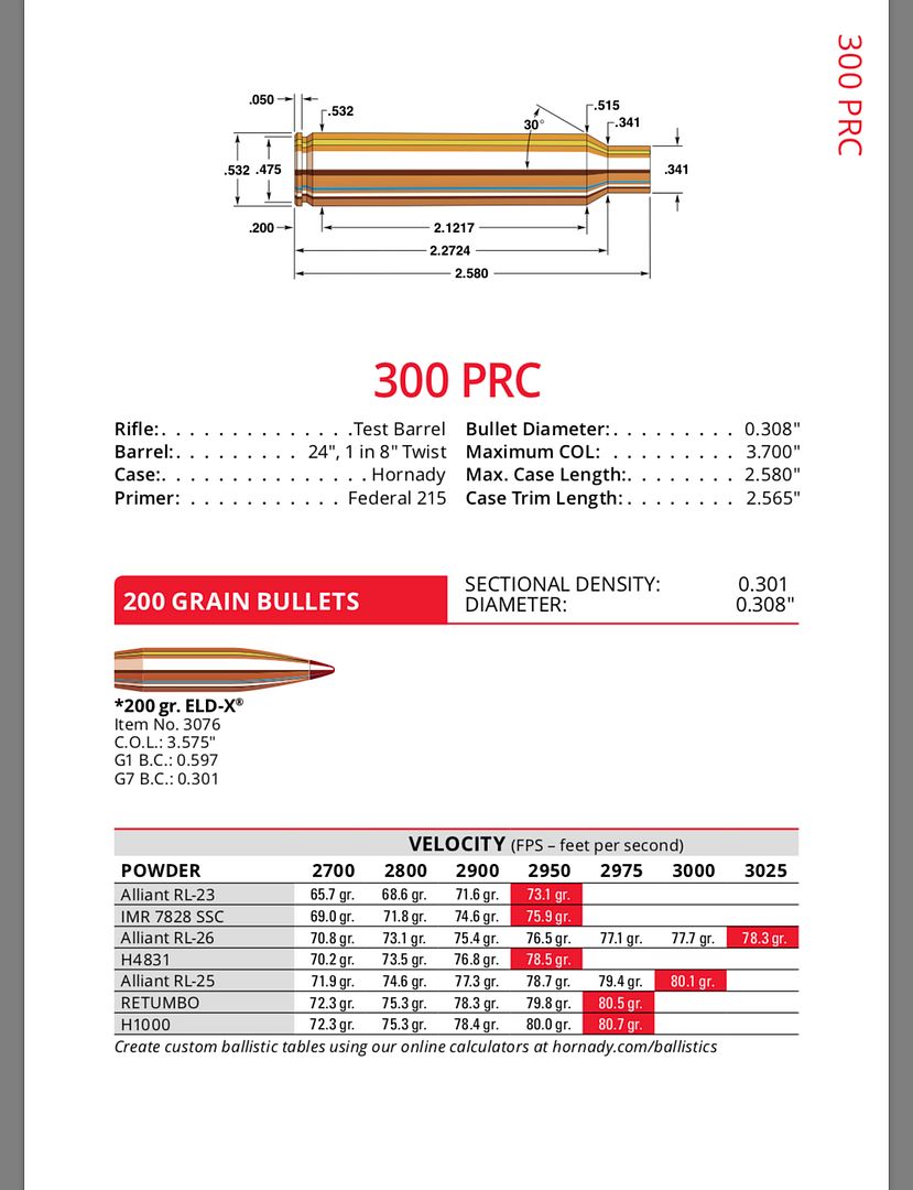

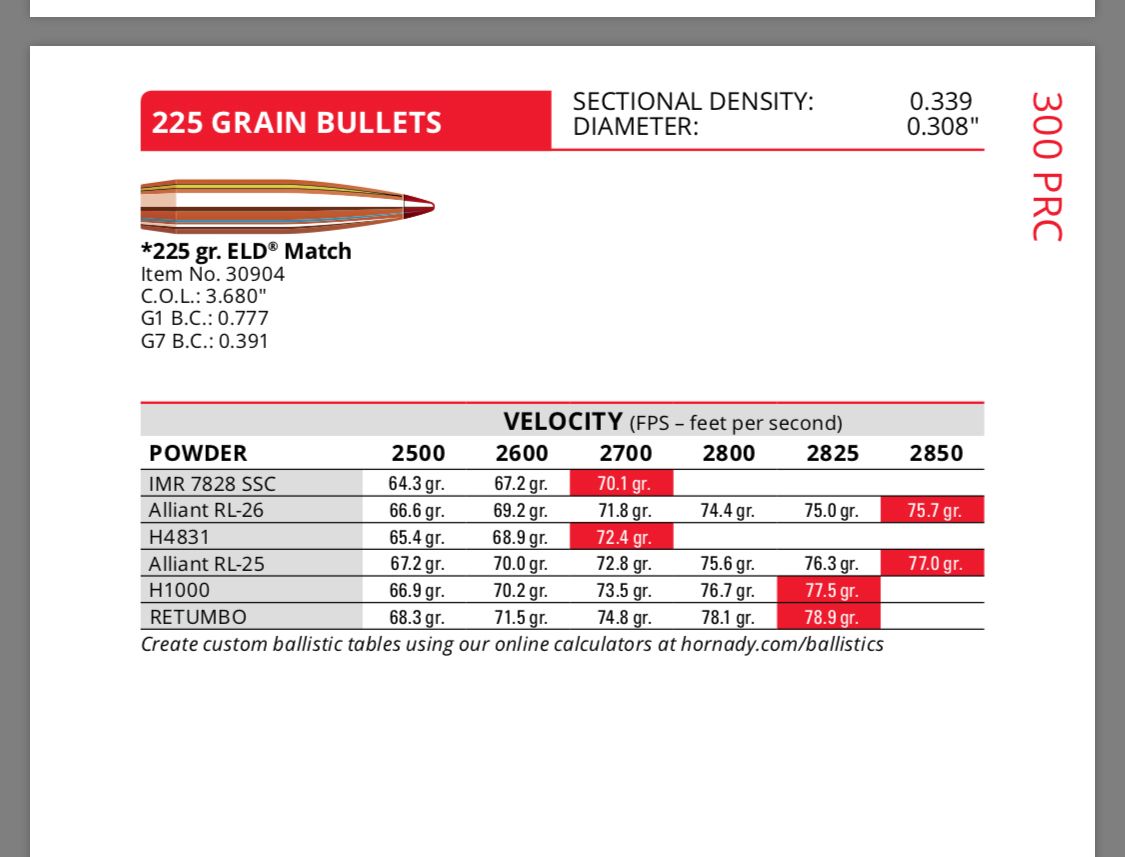

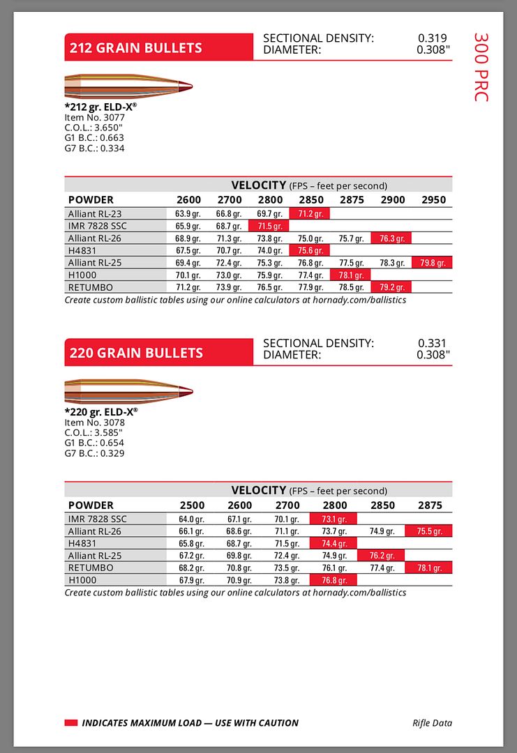

Hi guys,
any suggestions for Sierra 220 Gr HPBT load? I have Lapua brass, FED GM LRM primers, powder-wise ATM I have Ramshot Magnum and RS 76 - which is "similar" as H1000 on manufacturer's relative burn rate chart. But VV powders are quite easy to get here in Europe too, so no real limitation there I see. Should I start with 220 Gr bullet from Hornady's manual (ELD X) or mby Vihtavuori app as these two have plenty of 300 PRC loads covered? I have Bergara B14 HMR 26' barrel, 1:9 twist, intended use is target shooting up to 1 km. Thanks a lot for any suggestions and happy New Year!
P.S. I do know and rather be using Hybrids 215 + Grains, but these are totally non-real to get, maybe gone forever/long time. I'm running 200 Gr Hybrids with decent results, but wanna try some heavier load:)
EDIT. I have 2 pounds of RL 25 too...
