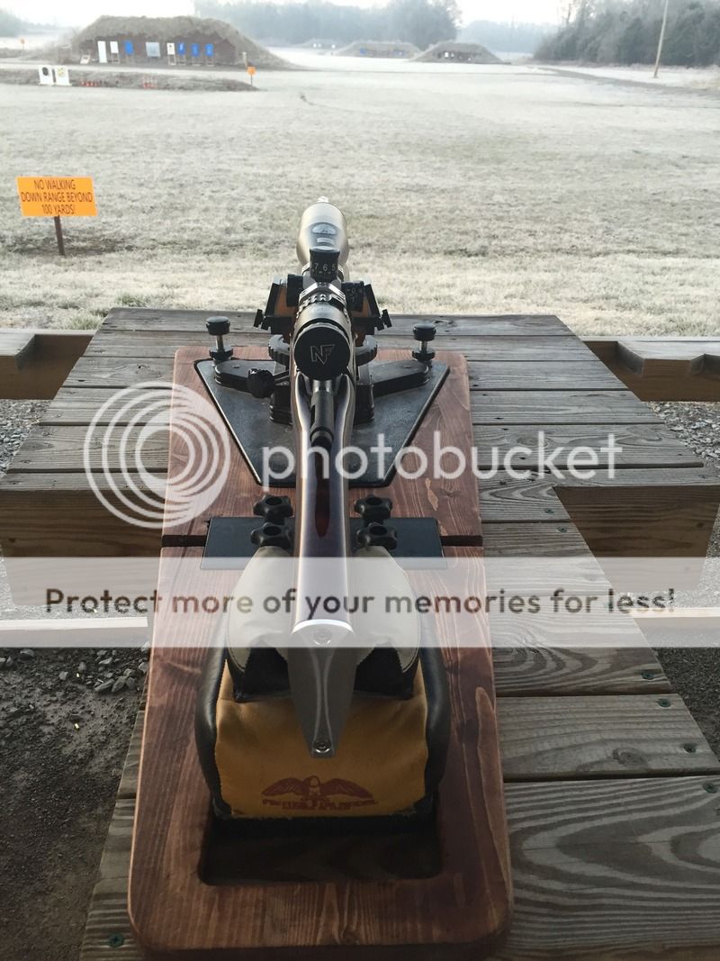

Here's what the morning looked like at 500 yards setup at 6:30 am it was a bit hazy then.

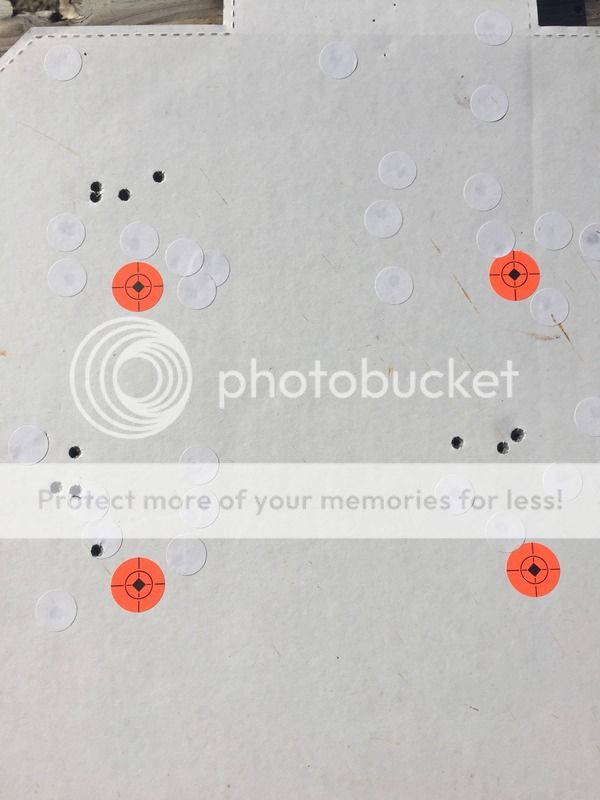

Now here's my target testing after the initial seating depth test. Top left is the 32.5 grain charge with the CCI 400, bottom two from left to right is 32.0 and 32.5 with the CCI450

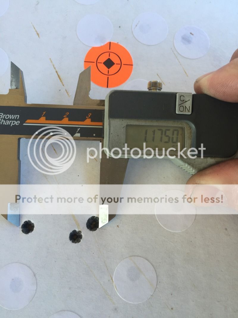

Here's the 32.5 CCI 400 group size with bullet dia subtracted.
And here's the 32.5 group size using the CCI450
Did I mention the mirage was miserable during this test? If not I'll say it. It was so bad I was afraid to even go look to see what mess I had down range.

Oh that bottom right target has four shots in case folks are wondering, there's 2 nearly in one hole.
Tell us about your rest set up and maybe another picture of it from the side. It looks very slick!!!
Basically it's a template I built to fit my front rest and bag. I set it up so I can remove the plate in the middle and be legal in IBS matches. I wanted something I could put my rest and bag in and sit my Rifle and move it all as one piece to align it to my target and still keep everything square and tracking true.
All it is, is 48" x 14 or 16" x3/4" shelving material. I laid it out so everything works off center line and then I cut and routed it out to fit the rest plate and rear bag snugly. The plate is 3/16 thick and I routed out the template to fit the plate snug and flush. I drilled the holes in plate and then set it into the template and drilled thru and put brass wood inserts in to screw the plate down secure to.
Very Nice, great idea!!! Who makes the modified base that your JJ rest is mounted to?
That's actually a Hart 1000 yard plate for their rest. I robbed it off my Hart setup to use in the JJ. I added it solely for weight. I felt the JJ just wasn't heavy enough to my likings.
Question, James isn't that considered capturing the rear bag? If it is then the rear part would be against the rules for LG.

Just cautious about 4 shot groups. Why 4 and not 3 or 5. Just trying to learn something here. Great shooting bye the way.:)

Shooting 4 allows me a better chance see what's going on to be honest. I could do 5 and I will once I get closer to temps I rather tune in besides 30* outside. Now I'm close and have a good idea what to do when it does warm up
No it isn't. The rear section can float around on the table. To capture the rear bag would mean to keep it from moving in any direction. My setup you can still slide and twist the bag if you desire. But that defeats purpose of using the template to keep it all square if someone wishes to change the bag position
Nice shooting James, I tend to also do 4 shot groups mainly because I just want an alibi during initial testing then move on to 5 shot groups (its because I'm cheap and don't want to waste another shot during testing). That damn dasher is nice, I've had 3 and wondered why I ever strayed because I just keep coming back to it for the next build.
