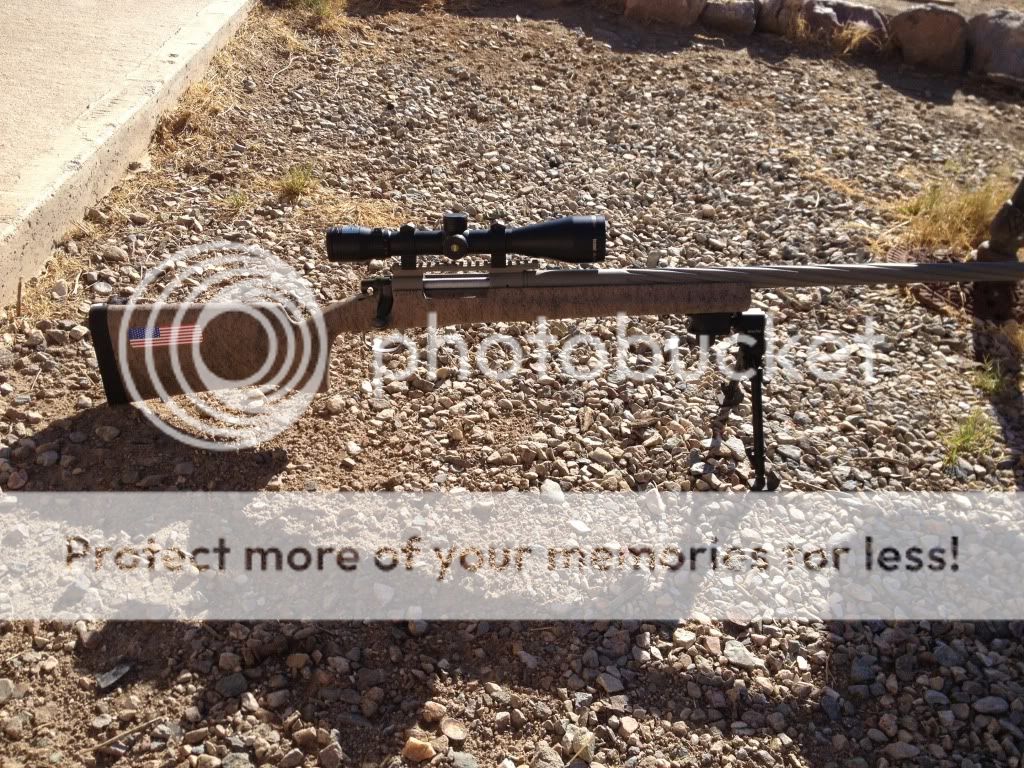

The rifle belongs to my best customer,with his blessing I'll Post a pic. As for your round count,that is an exceptional number of rounds through a barrel chambered in that cartridge. I build as many rifles chambered in 7mm Rem Mag as all the others combined,and can tell you that's not the norm for guild accuracy.That being said i believe The Yukon should be good for 1000~1200 rounds of "good" accuracy and reasonable cleaning, depending on how hard one pushes it. That is however an educated guess as none have been tested to failure. There are no free rides.
I don't run balls out. I run my 162s at 2960-2975 and 140s at 3300 thereabouts. I've been shooting this rifle since 2007
I've been waiting for accuracy to fall off so I can rebarrel to the practical. But I guess I'll build it on a savage action
