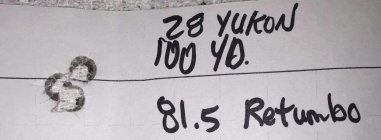

Update on Yukon, bbl now has 160 rounds through it and averaging 3221 with a 180 JLK. Performance is awesome with groups averaging .400" but have a few sub .280". The thing is a dream to shoot

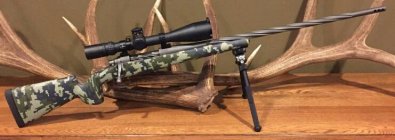

28 Yukon #2
Defiance action, Brux barrel,McMillan Gamescout edge stock and Nightforce optics Performs similar to #1 velocities similar with 180's as well (3220-3230 fps).This barrel appears to be a little slower than #1 with equal powder charges.Time will tell as #2 has fewer rounds through it as well.

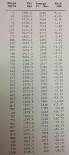

I am a little slow on the uptake,but i missed your point.Anyone shooting at game beyond point blank yardage owes it to the animal to take atmospheric conditions into consideration as well as ballistics of the combination they intend to use before attempting any "long" shots on a game animal. they should practice a great deal in field conditions beyond what they will consider their comfortable maximum yardage to take a shot on an animal.The following chart is based on the bullets we are shooting in the Yukon and have proven on Game at extended yardages.

Craig,
Here are the numbers using your 175gr nosler partition @ 2900fps and their published B.C.. All atmospheric contitions are identical to chart for the Yukon.As you can see there is a very large difference in drop as well as impact energy and wind drift(not shown) between it and the Yukon.Not sure if this was your point but,i believe the two cartridges are apples and oranges.I'm not saying i would send the 284 packing as it is a proven cartridge for your intended application.

The spirals do look cool for sure but my intended purpose of having this rifle built was for hunting and spiral flutes shave more weight than straight or interrupted flutes. I wanted to keep the rifle around 9lbs. A consistent rig that shoots under half moa 90% of the time works for me. I have no doubt this thing would shoot better with a big tube on it but I'm too lazy to hump the hills with a heavy rifle ;D
All my expectations have been met with this project and I'm really interested in the bbl life. Where I live it's hard to beat 17 moa to get to 1000 with 1860 ft lbs of energy!
