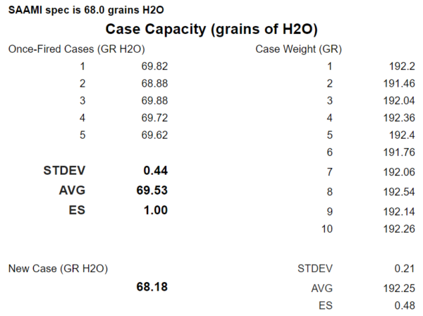

Starline Brass 30-06 Springfield Unprimed Bag of 100 $46.99 $0.47 per round...........vs Lapua $0.98 per round
https://www.grafs.com/retail/catalog/product/productId/81799
TESTED: NEW 30-06 Brass from Starline
https://ultimatereloader.com/2019/12/10/tested-new-30-06-brass-from-starline/
