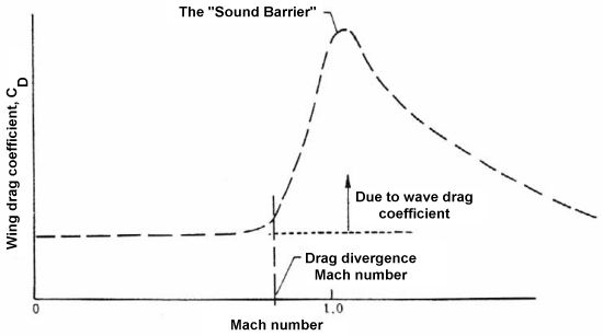

There is a large increase in drag as you approach Mach number of 1 (the sonic barrier during days of old :) Beyond Mach 1, the drag drops again.
One nitpick - drag does not drop as velocity increases, it increases. The drag *coefficient* drops.
The reason for the observed phenomenon is the massive spike in drag coefficient at Mach 1. This translates to a sudden jump in drag at mach 1. Any time spent above mach one exposes the bullet to a drag force that is a multiple of what it is below mach 1 even though the bullet is only going a little bit faster. That's what does itScreen Shot 2017-11-27 at 5.11.33 PM.png
