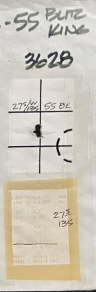

Initial load workup @ 100 yds with 55 blitzking. Ramshot TAC. 27.0gr .010" off Jam seems like good enough place to be. Worked up in 1/2 grain increments from 25.5gr to 27.0.
25.5gr load produced sub 1/2 MOA, but not as good as 27.0
Rifle is a factory Bergara Premier 20" heavy barrel .223
Point of impact shift (up) on one group was due to magneto speed. Velocity was AVG 3231 out of the 20" tube.
