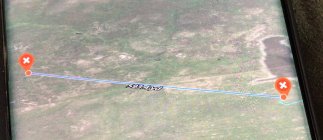

I have been shooting the 53gr V-Max since they came out.
Love them, at least in my builds.
They perform very well at distance also.
Last week I had a confirmed PD kill at 593.4 yards.
This type of debate rages on at our club regularly.
Bottom line shoot what works for you!
