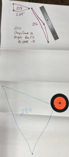

Now that I've had a few days to organize and get everything put away after 1k nationals at Deep Creek, here are some pictures of the targets I shot. I have many excuses, but ultimately I just wasn't shooting very well. Practice on Thursday and Friday showed some significant promise, and I think there is a lot to like in what I see here. It took 37 MOA for the 222 to get on target at 1000. The 22 PPC only needed 28 MOA.
Starting with the PPC, I struggled a little on Thursday:
The nodes looked good, and I concluded my +7 seating depth was still good. Friday, I tested it again:
Wowzers! 1.166" and this Varget ladder looks suspiciously like one of my 500yd tests where 28gns of Varget went really small. I decided to load this for the match, and used my 22 PPC in LG:
I don't feel like this represents what this load and gun can do, so much as it represents where my skill level was at for Deep Creek.
Next up the 222 on Thursday proved tricky simply because I was shooting blind and didn't realize so many were popping off the top of the target:
That little dark green group is a phenomenal 1.62". It may have just been luck, but the dark red 23.2gn load measures 3.58". On Friday, I repeated my ladder and caught all the bullets this time:
Well, I didn't have time to do more and this was already getting crunchy full with a 12" drop tube and slow pour, so I decided to load 23.8gns at a .009" jump (-9 in my target notation), and took it to the match. It looked like, at the very least, the climb up the target was rapidly slowing down and even if this wasn't a great node, it would be more stable than a lower powder charge.
I'm pretty proud of that 9.56" group that scored 90. I also feel like I was calling the crosswind pretty well for how sensitive this 222 is to the wind. There was a good strong headwind that was quite variable, and during sighters I discovered that the difference between the full value headwind and when it "let up" was about half the whole target in vertical change. I used the angle of towels that were hung in front of the benches to block the morning sun as my headwind gauge and for the one good target, I did feel confident in how I had read the towels and chosen my shots.
