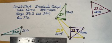

Please bear with me on these targets. I realized that I packed them with a lot of info, but I'll summarize after I get them all up here:
A couple ladders with Berger 85.5gn LRHT. No node with IMR-4895 where my notes showed one to be in the past. IMR-4320 behaved pretty nicely, but you can see the wind in action. I won't kid anyone; the 222 requires you pay attention. It doesn't have much speed or BC to carry the day when you decide to go ham and stop watching the flags and mirage carefully. The speed that I run the 3-shot groups is the only thing that saved some of them from being absolutely gigantic.
Seating depth test. After a snafu with my notes, tools, or more likely baby-addled sleep-deprived brain, I couldn't track down where I was in regards to the lands and didn't want to strip the bolt and recheck, so you'll see that I am reporting my depths in comparator o-give to base today instead of my normal +/- thousandths to touch.
I noticed that some of my low and high shots that spread out some of these groups also corresponded with high and low velocity. It's not a sure thing though, because at different seating depths, it magically got tighter (size and ES). I'm going to be tracking this, as the 222 seems to have wider spreads than I'd like in both group size and ES, despite the same care being taken as with the PPC and BR, including sorting on case weight. I may start sorting the 222 by if it shots fast/hits high, or shoots slow and hits low to see if I can get this variation out of the system.

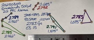

PPC ladder 90SMK with IMR-4895:
Looks pretty good - aiming at the "low node" that I've seen really shoot in the past.
