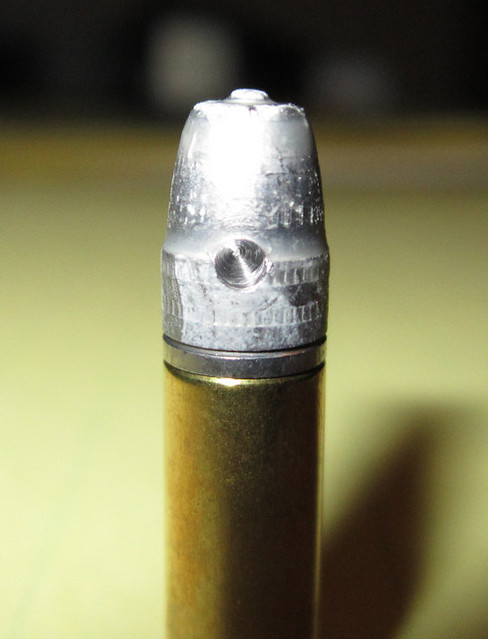

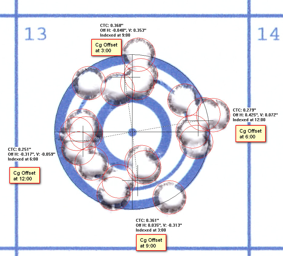

An offset Cg (Center of Gravity) causes the projectile to be imbalanced and it's forced to rotate about the geometric axis while in the bore of a barrel and this is an unnatural condition.
A spinning projectile will always spin about its principal axis and the principal axis always passes through the projectile Cg if it’s free to do so.
Due to the Cg offset, a tangential velocity component is produced while the bullet is in the bore.
Consequently, the bullet will start spinning about its principal axis and its Cg the instant it exits the muzzle.
This tangential velocity component creates a lateral drift velocity when the bullet exits the bore.
The direction of this lateral drift velocity will be perpendicular to the plane containing both the geometric and principal axes at the instant of muzzle exit.
With the Cg offset located below the geometric axis in the chamber, the bullet will be deflected 90 deg's to the left and impact at the outer edge of a circle defined by the calculated "Radius of Dispersion.”
This equation for the Radius of Dispersion = 24 * Pi * (MV / Twist Rate in Inches) * TOF * Cg Offset in Inches.

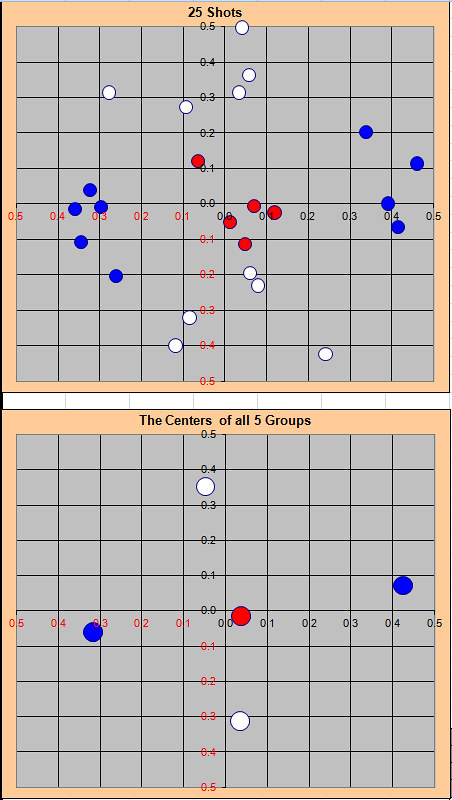

Every shot in the charts below was fired with the POA being the x,y coordinates of 0",0" and the 5-shot group in the center was fired without any induced imbalance on my part.
