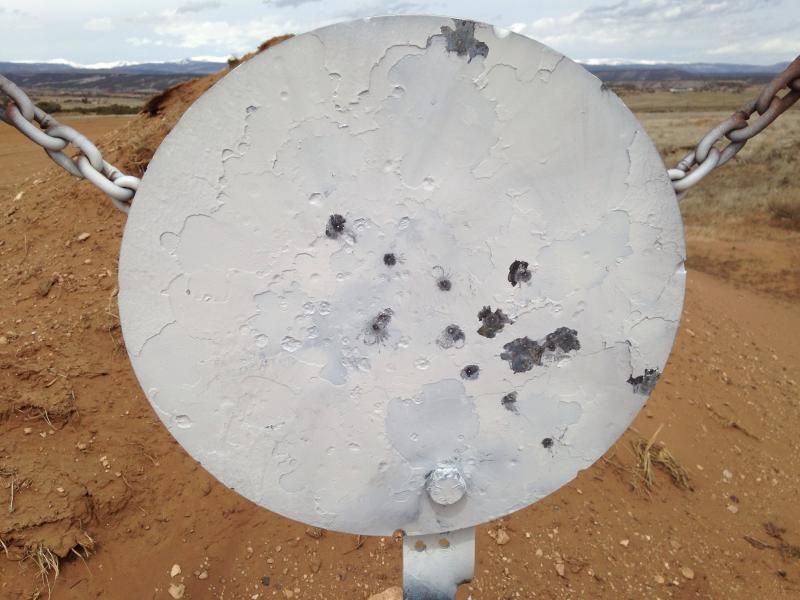

And my 400 yard gong on a calm day (lol, just ignore the 3-shot group from the 6mm)

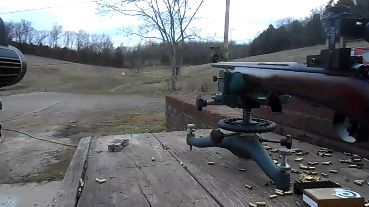

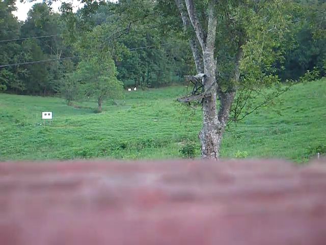

Here is what we do. I made a large "Dirty Bird" type home made target. Then I replace the target in the center when we are shooting groups/changing shooters. 300 yard hits are no problem to see through the scope.
You can see in video below, where the first couple shots were before elevation windage corrections were made.
This 300 yards with CCI Blazer that chrono'd 1260 FPS through a suppressor.

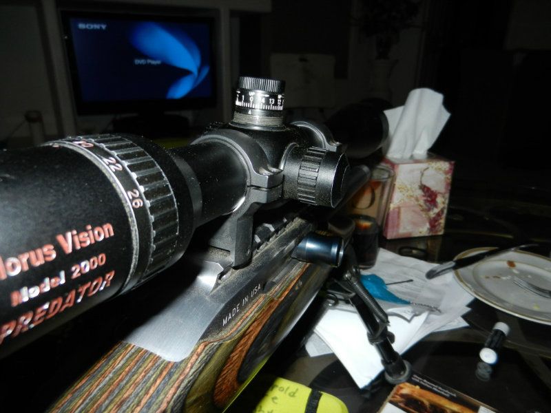

Also love to shoot the little bullet to long distance and have started messing around with doing it with pellets trying to snipe frogs at long range in the Philippines when bored, believe it or not. Really is a kick for sure. It's often quite dry at our local range, and bullet impact can be seen even at extreme ranges. I have shot all the way out to 600 yds. with the big pistols we use and it is quite fun. I have an 8-26X Horus Vision Predator on this MR Picuda mounted in Burris rings using the +/- 20 inserts shimmed with plastic strips between the insert and scope tube with the correct thickness such that when zeroed at 100 yds. I have 5 MOA or less of DOWN left in the optic's turret, allowing me about 150 MOA of UP reticle+turret--
You can see the white plastic shim between the +20 insert and scope tube in this pic--

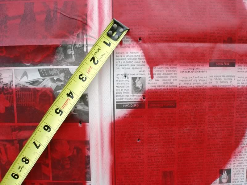

I made a stencile for an 16 inch target I spray paint newspaper for 200 yard targets and can usually hold 4-5 inches prone with the Palma sight on my CZ 452 Ultra Lux in a mach stock,,
