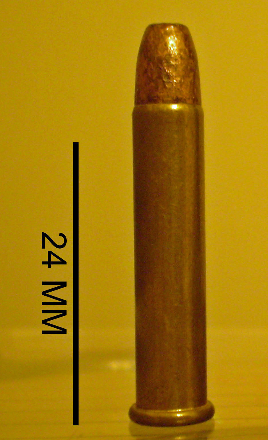

22 Mag overview:
Even in the mid 2000's the Hornet will well outperform the 22 Mag.

22 Mag overview:
