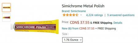

I seen the article from Alpha. However, I live in rural Canada. No Simichrome anywhere up here. Amazon Canada has it for $37 a small tube! I can get Flitz and Brasso.
If you have a place to buy Iosso Gunbrite that will work well too.
I have used it for carbon rings and for wiping carbon off muzzles behind the radial brakes of my BR guns.

Oh, I have access to it all. Most of it is around $10 and another $20-$30 for shipping. About the only thing I can get here is Flitz but there are report of barrels being ruined with it due to it polishing the leade (not good)! Free shipping from Amazon Canada LOL!
No Flitz for sure.
I think it is going to take a lot of work to get that ring out. Sounds like it had been building (previous owner) for quite some time.
