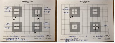

Looks like 1680 really tighten things up at 100yds. I can live and work with this. 14grs of 1680 is almost to the base of the bullet though max is over 15. I'll never fit that in the case. 35gr vmax on left and 40gr sierra #1385 HP on right both with 14gr 1680. No pressure signs. I may take the lilgun out side and light it just for my aggravation. I may end up using the h110 in something else. May get a Lee FCD and try crimping.

What wasn't successful? 1680 shrank my groups by half or more. I was about ready to sell it off.
