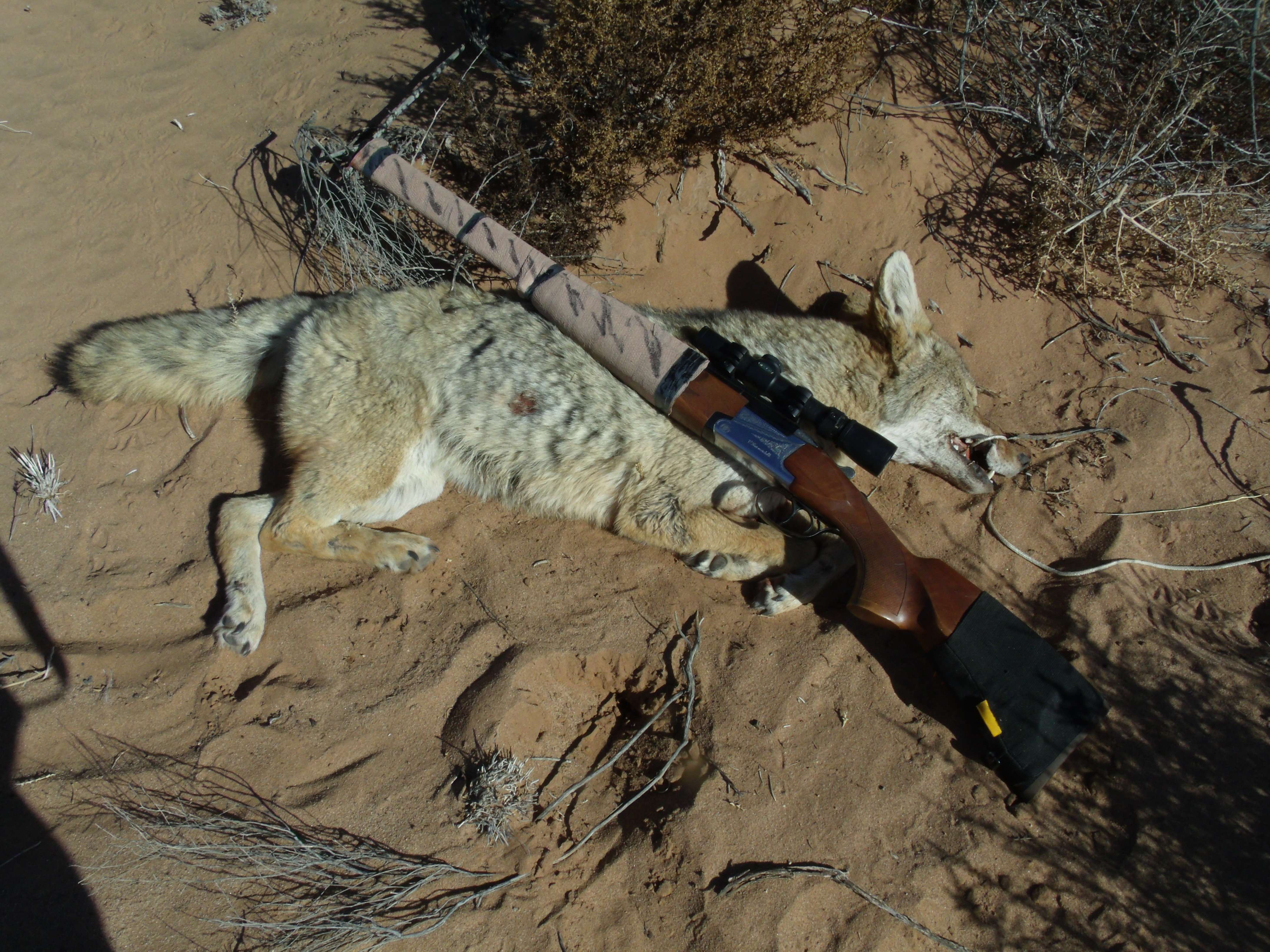

I've been shootiing the 22-204 since 2006 and is one of my favorite pelt hunting rifles. 40gr NB at 4000 fps out of a 22" barrel, Sightron II 1.5-6x40mm

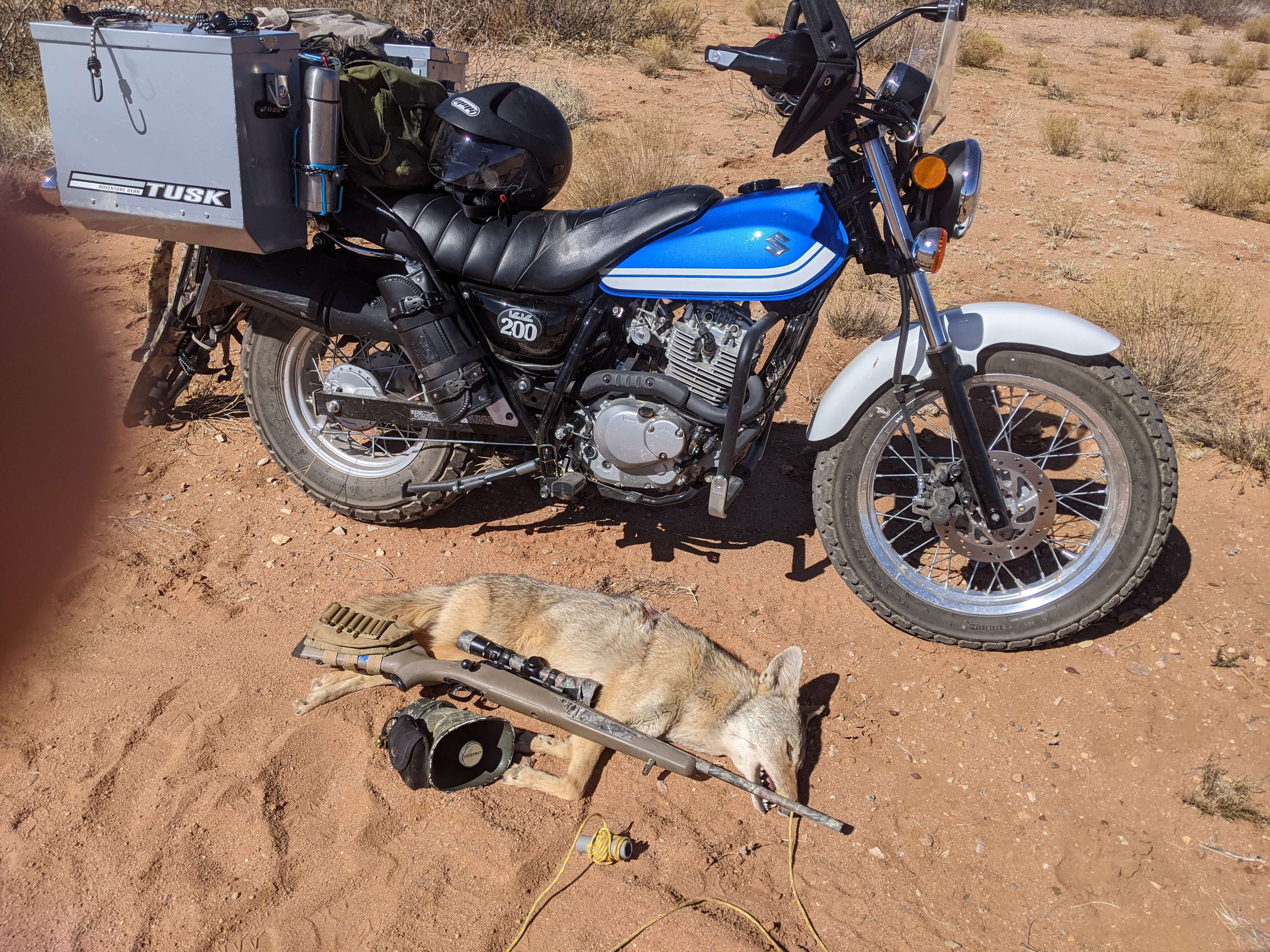

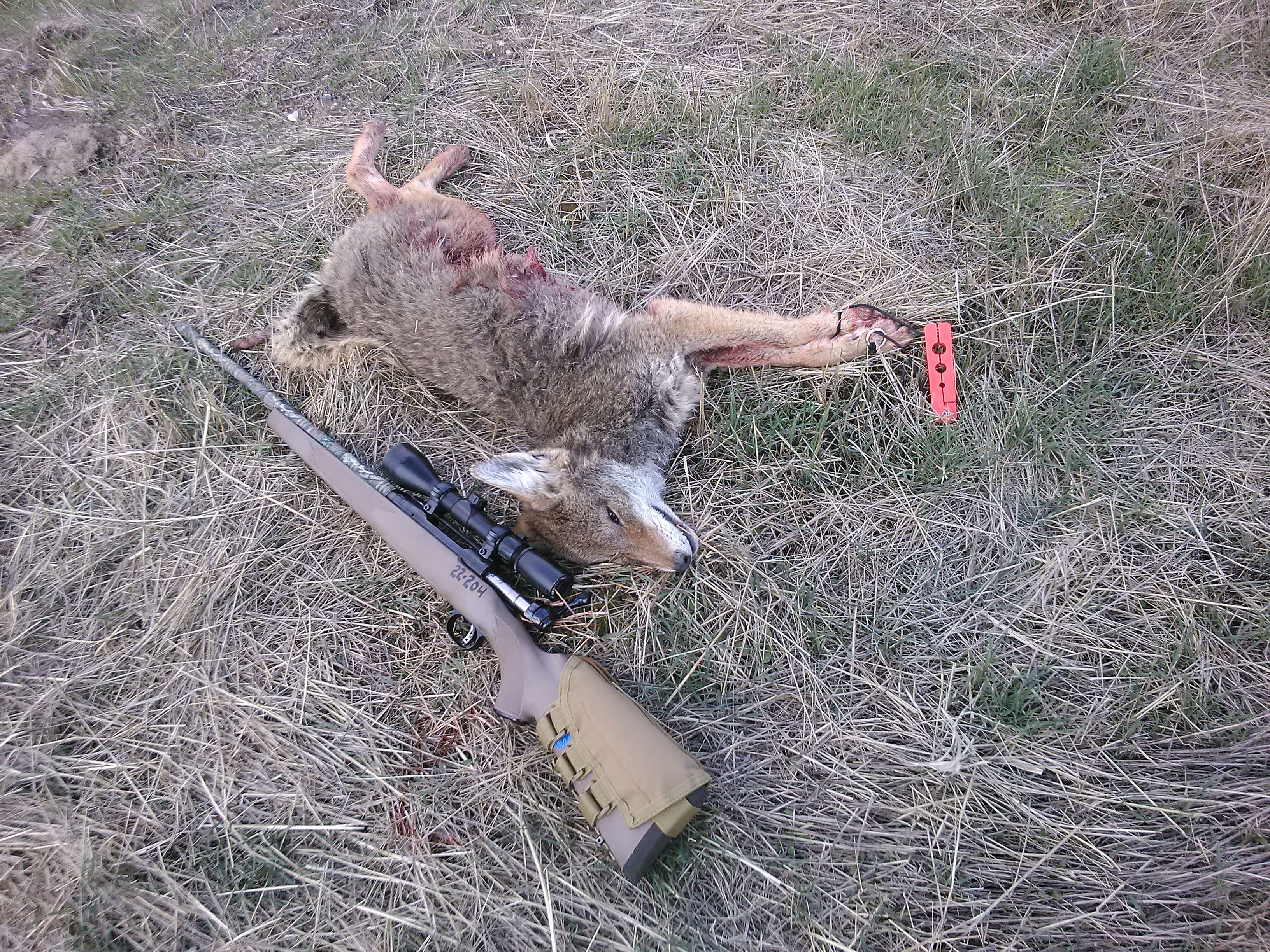

Last coyote of the season, pulled the plug when I saw the fur on this. I was experimenting with lead-frees.

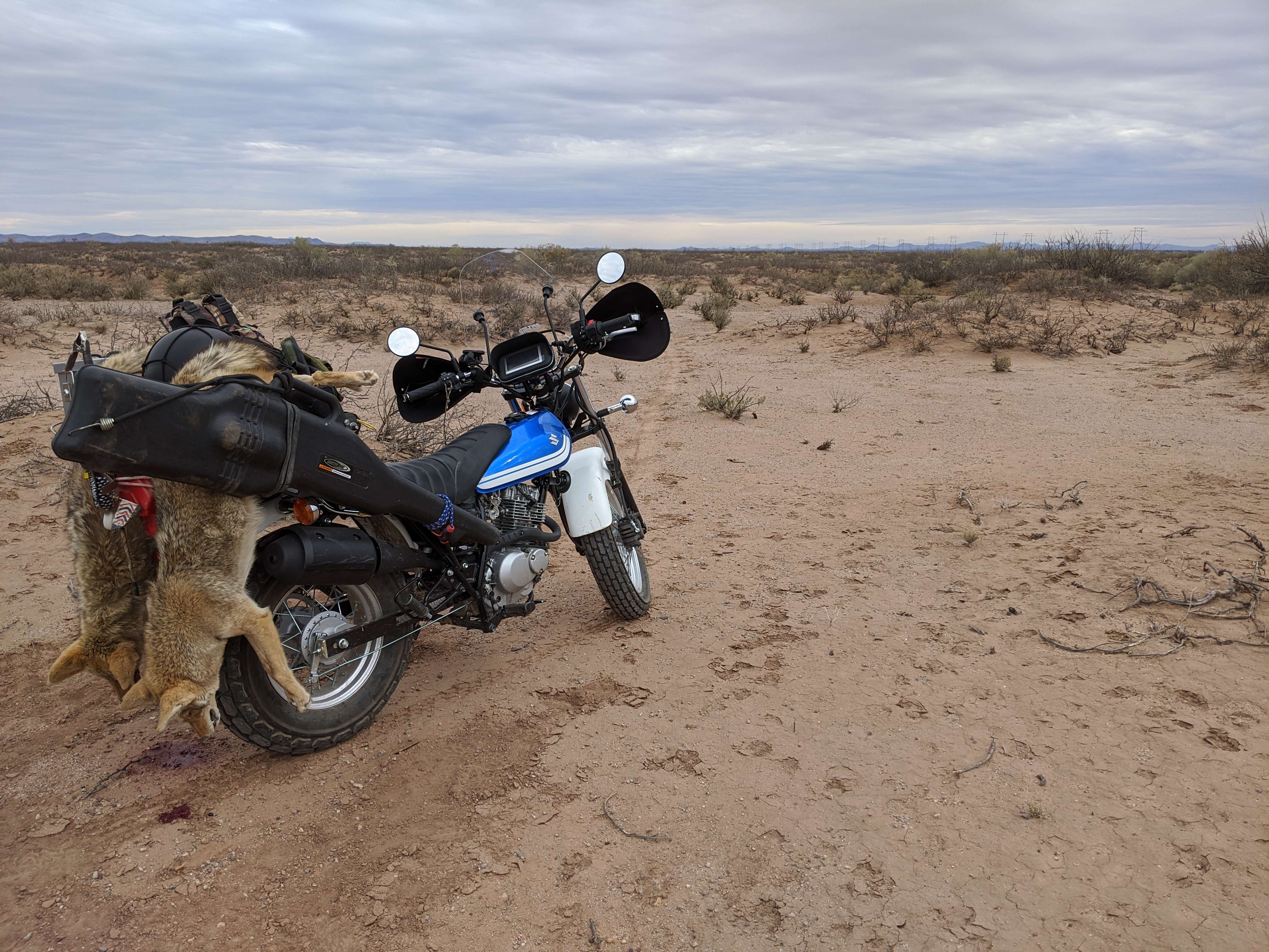

Last one 2021 same rifle and scope

@AWS love the bike! Looks like a great way to stretch your range. How's it handle off-road with the added bulk?
It handles very well. It spends most of it's time on two tracks out in the desert, most too rough for my truck. Plus I can travel the highways out to where I'm going to hunt. On State and BLM lands we can't drive off of a designated road(although it might not have been maintained in the last 50 yrs) so the bike is perfect for me since it rarely gets below the mid 20's in the winter. 80 mpg is nice.
If you want more info PM me, we don't want to highjack the thread.

15 miles north of the Mexican border
