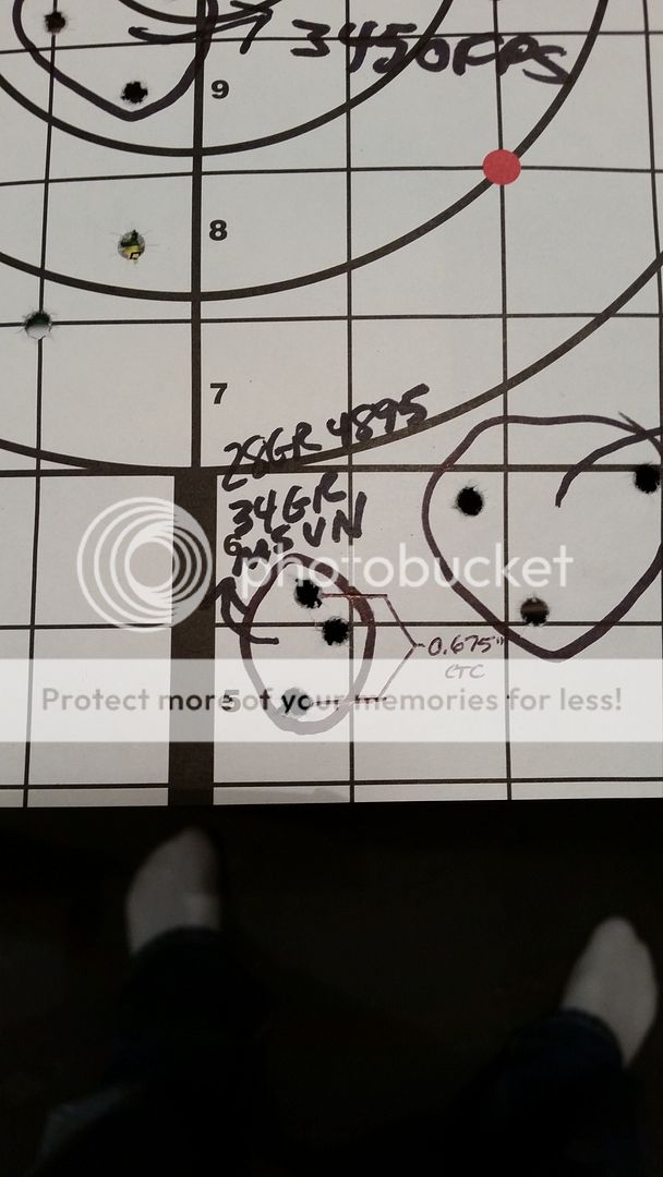

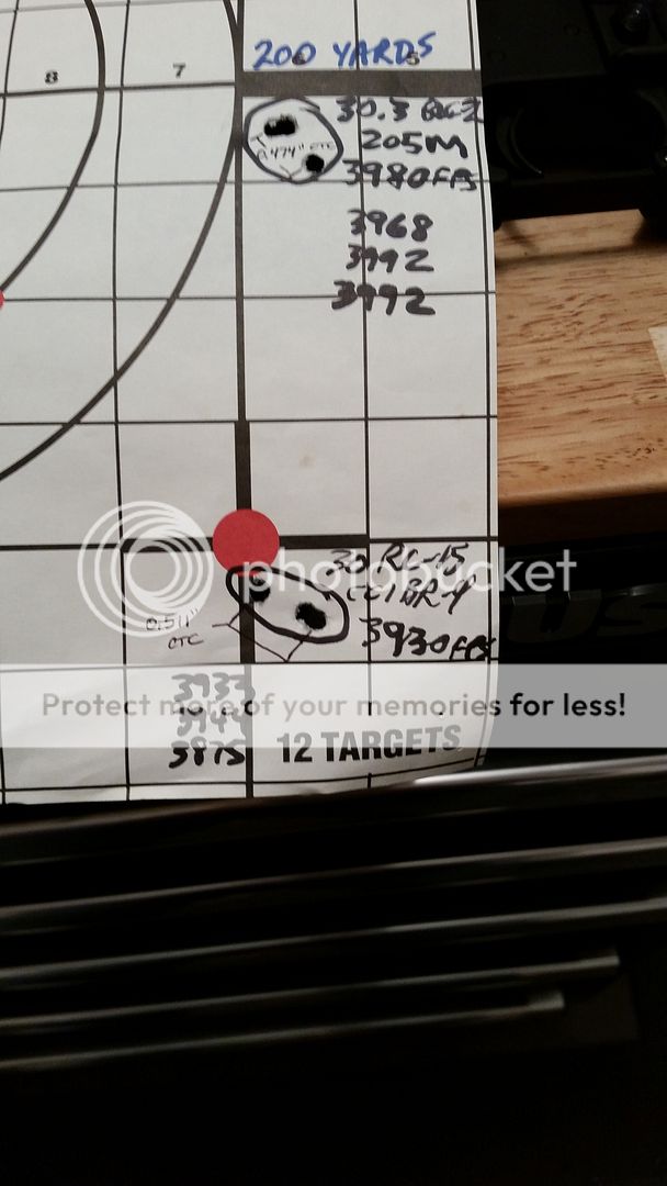

Here's one of the targets from my 204 Ruger 200 yard load testing. Sorry it's sideways. Lol
I did some tweaking to the seating depth and got it shooting as accurately with RL15 as the target shows with the BLC-2 powder. Can't find that target though...

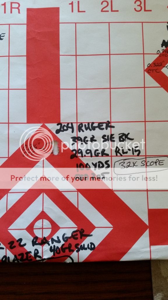

I did find one of my 100 yard targets when I was playing with RL15. This one is 29.9gr. Still can't find my other targets with 30gr load of RL15...
Anyhow, it will hold that 1/4 MOA accuracy very consistently at distances to about 500 yards if I can get a dead solid rest and there is NO wind. doesn't take much wind to screw those little bullets up.
Oh crap! My 200 yard RL15 load is on that first target picture. It's down in the bottom cut off from view. No wonder I couldn't find another target, it's on the same one! Oh man I'm starting to lose it ::)
I'll see if I can take a better picture and post it showing the 30gr of RL15 when I got it shooting better. I forgot that I also went to a CCI BR-4 primer.
Ok...so I lied. The group measured 0.511" at 200 yards ::)

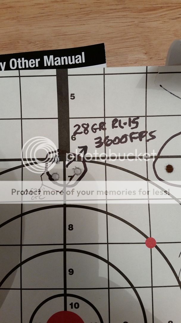

But here's another good group it shot at 200 yards with 28gr of RL15.
It also shot really good with IMR 4895 at 200 yards.
So as you can see. The 204 Ruger can do everything you desire for good Varminting accuracy if you're willing to work with it. I know every rifle is different, but the 204 can be very forgiving and easy to load for if you do it right. Mine shoots very well with multiple powders so I really can't ask for anything more.
