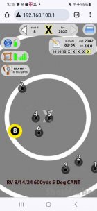

Back to range today (8/8/24)
600yds with 5 -6 degrees cant.
S2 is high in the 8 ring.
And, back to 600yds today (8/14/24). Final practice before match on Saturday.
3 shots then adj scope 0.1 mil left, 0.2 mil up, then a 5 shot group.
CRAP, Just noticed, ShotMarker was set up for MR-1 target :(
