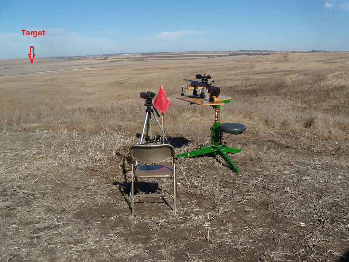

At the portable "Big Shooter" bench firing position (above)

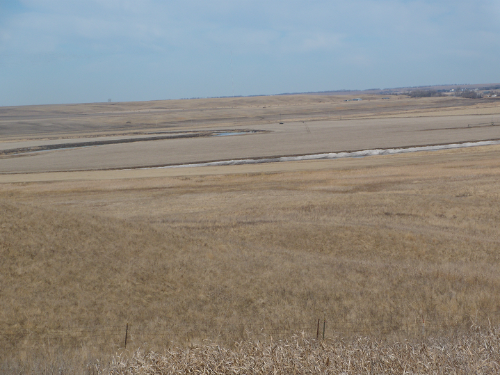

Down range to 2001-Yards (below)

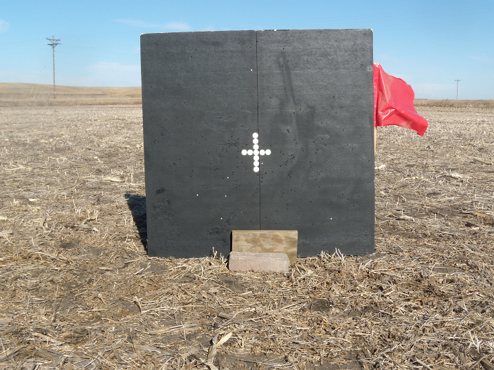

The Target (below)

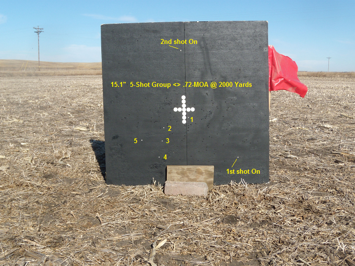

5-shot Group = 15.1" - .72-MOA (4 at 8.75" / .418-MOA)

Preset the adjustable mount to 100-MOA at 100yds at my range.
Drove to the location and setup <> James River valley in LaMoure County, ND.
Started out by adding 24 more MOA (124 Total) of Elevation.
And dialed 3-MOA of Left (2.6-MOA for spin drift plus a little for the 6:30 to 7:00 wind).
First shot splashed Right and a little high
Dialed over and fired, impact was behind the board so we figured it went through.
Fired 4 more and drove down. None on, but impacts showed they went over the top but not by much.
Knowing were close we set up the forward spotter - Keith at 200' forward and left - with a car for a barricade.
Drove back and dropped the elevation some and fired <> in the dirt low right (blew dirt on the target board)
8th shot <> dialed up and over <> On - low and right
9th shot <> dialed up and over <> On - center high
Dialed down and ran 5 shots <> results above in pictures
Symmetrical bullet holes that showed good stability
