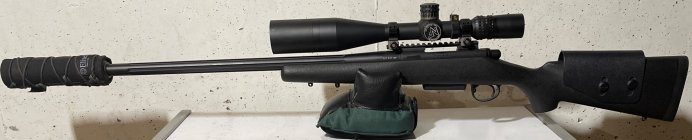

"Have you ever HAD a 223 Ackley there fella?" Oh, you mean like this one? Only for about 15 years.
