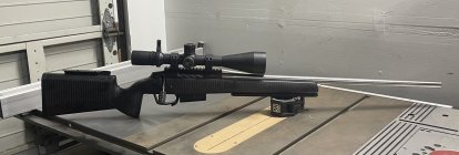

Here’s the specs on the rifle for those who asked:
Tikka Action
Pacnor 1:9 26”
Manners EH1-TK
Atlasworx DBM
Nightforce NXS 5.5-22
Mike Bryant did the work.
