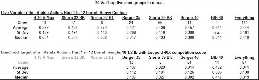

I have experience with two Twenty VarTarg barrels that have 12" twists, as close as I can measure (next one from the same supplier came out 11.5" - glad it wasn't 12.5"). The 12" twists will shoot the 39 Sierra well - my go-to woodchuck/prairie dog bullet. For target, one seems to shoot better with the 35 Berger; the other with the 40 Berger. Neither seems to perform well with the 40 Hornady. Your results may vary.
