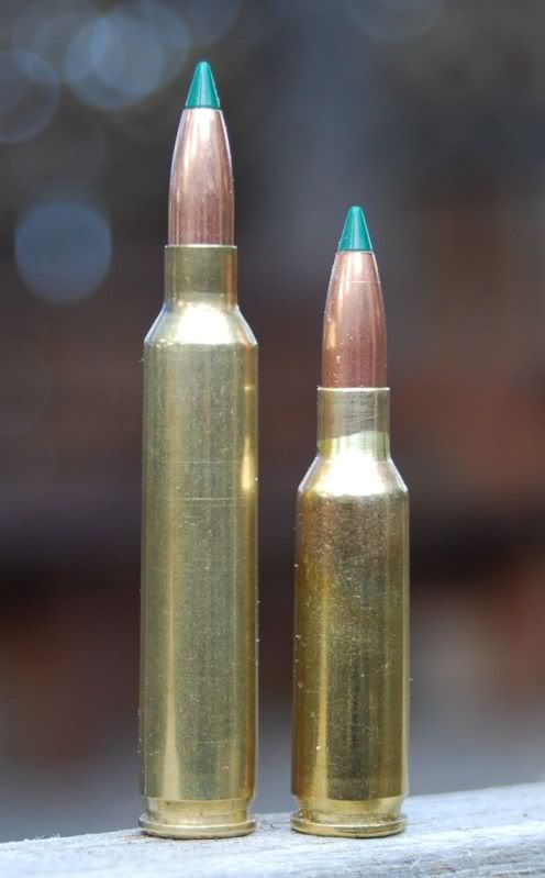

Here's a comparison of the 204 Ruger and the 20VT, both loaded with 32gr SBK's:
I've been shooting 650 pcs of reformed and annealed R-P 221FB brass, some have been shot six times (neck-sized only now), and they're still going strong with tight primer pockets. Adam Bently here produces the very finest 20VT brass, reformed from LC 5.56 cases, and his brass should last virtually forever in a 20VT with any sane load.

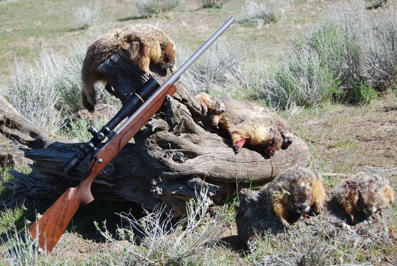

And as we all love gun-porn, here's a field shot of my 20VT doing what she does best......make life difficult for the local rock chucks, and put a smile on my face, all at the same time. ;)
See all your hits/misses, miserly on powder, very mild blast (almost could be called 'quiet'), zero felt recoil and wicked accurate. Don't confuse the 20VTT with this one.....BIG difference; Advantage: 20 VarTarg.
