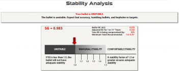

I have the parts to build a 20 caliber rifle. I was thinking about using Hornady 40 gr V-max bullets. My barrel has an 11 inch twist. Will that twist work with those bullets?
Here is a bullet length database from JBM Ballistics.
https://www.jbmballistics.com/ballistics/lengths/lengths.shtml#Hornady
It shows the 40 VMax at 0.752" to the tip of the plastic point, (and about 0.620 to the hollow point based on my measurements.)
You will need the stats from Hornady as well.
BC is 0.275, sectional density is 0.137 (not required).
https://www.hornady.com/bullets/rifle/20-cal-204-40-gr-v-max-250#!/
Then you go to Berger's stability web page.
Punch in the data and your bbl twist rate and speed. I will guess at least 3600 fps, faster just makes it better.
https://bergerbullets.com/twist-rate-calculator/
At sea level you would not be happy with an 11 twist. You would probably do better with a 10 twist and some altitude. I run the 40 V-Max in a 10 twist with no issues down to 2650 ASL.
With the HOR 20 cal 40 gr V-Max he will be unstable according to Berger's stability calculator. At sea level.
I can assure you there isn't a 40 grainer out there that a 11 twist won't shoot just fine.
A 12 twist that's different story
I hear what you are saying and don't doubt you... but I cranked the Berger stability model for the 40 V-Max and that 11 twist and you can see how it looks in terms of SG margin. How high are you shooting? I have seen 40 V-Max keyhole with 11 twist at ranges closer to sea level, then turn around and start working fine at 6k.
I shoot the Sierra 39 and Hornady 40 V-Max all the time, but I am at 10 twist and shoot from 2650 on up to above 7000 in some spots with coyotes higher than that.
With enough altitude and speed, things improve dramatically in terms of that SG stability margin, so some of the times when we don't see keyhole behavior it is due to the thinner air at altitude. Other times, the ballistic tip versus the bullet model accounts for some differences. YMMV
How are you using the Berger twist calculator on a 40 gr vmax horny bullet.
You run the 40 gr berger at 3650 at sea level and the sg number is 1.32
The Berger bullet is shorter, and that makes a huge difference.
The point to all the early steps was to show how to use that Berger SG calculator with any bullet that you can find the length and BC for.
Hornady 20 cal 40 gr V-Max is 0.752" long and has a G1 BC of 0.275
Berger 20 cal 40 gr BT is 0.680" long and has a G7 BC of 0.116
Sierra 20 cal 39 gr BK is 0.737" long and has a G1 BC of 0.270
When I shoot the Sierra 39 BK at 2650 ASL in a 10 twist I am SG = 1.36 and it can be touchy, when I shoot it at 6000 ASL my SG goes up to 1.54 and I am golden.
With an 11 twist at 2650 ASL, my SG drops to 1.12 but if I climb to 6000 ASL my SG goes to 1.27 md I may or may not get away with it. Much better off with the 10 Twist.

Then explain to me why a .737 39BK will shoot out of a 12 twist but a .752 won't out of a 11.
Run it on JBM and take into account the plastic tip on the horn and see what you come up with.
I'm not going to be the guy to explain when one tips over and another doesn't.
I sat with my mouth open when the ballisticians convinced me I had to go from rifled 105mm to smoothbore 120mm.
In your example above, a 1.279 SG is less than a 1.5 SG so strange stuff can happen both good and bad. I won't take credit or blame, but I would go to more twist if it were me.
If he already has an 11 twist, then he can see the issues and judge for himself if he wants to jump to 10 or stay at 11.
I don't doubt your experience at all, it matches some of mine and that of many others. Those models are just math that mimics observations in labs. The SG margin isn't the same as calculating force equilibrium that tips a bullet over.
Sometimes a guy gets away with it, and sometimes he doesn't. I make no claim on the issue of my own, I am just sharing the model and how to crank it. Gyroscopic stability of 1.5 or more is known to be solid. Below 1.5 we all know it can be risky as the value drops. By the time we are at 1.0, we all know what happens and in between is the risky zone. YMMV
The O.P has ordered his barrel i believe, point is theres probably 100's of 11 twist out there that are shooting 40 vmaxs.
I've shot plenty of 1.3 SG's and will do it again.
Hell theres some on here who shoot BR that prefer 1.3SG
