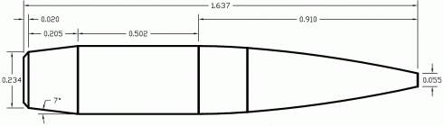

Bryan, here is a question for you. The 180 Hybrid needs at least a .200 freebore (more is better) and the 180 VLD's need at least a .220 freebore, what would you expect as the MINIMUM freebore necessary for the 195's? Thanks..
[br]
Ben,
When Bryan first released the bullet drawing, I calculated a .233" freebore would allow sufficient room to jump. My 7-270 WSM reamer is made with that freebore. I'm also interested to see what Bryan has been using or if the bullet has changed.
Steve Blair said:
[br]
Ben,
Steve, I am having a 1-8tw Shehane made up as we speak,in anticipation of this. BUT my freebore is only .220.. What is nice though is that my 'smith has ordered a 7mm Unithroater should the need arise.
