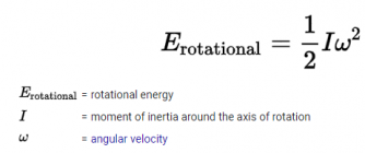

One factor almost never discussed is rotational energy. It’s a major element in terminal performance - especially with frangible varmint bullets. I first learned about it decades ago while reading the chapter about shooting feral burros with a 220 Swift in PO Ackley’s first manual. A 17 caliber bullet at 3800 FPS in a 1-9” barrel is spinning at 304,000 RPM. The 20 caliber bullet at the same speed is rotating at 228,000 RPM from a 1-12” barrel. Adding that the 17 bullet is likely running a faster velocity, the difference in lateral energy will be even higher. Unlike velocity, rotational speed remains relatively constant during flight. I am not stating that this makes the 17 caliber superior but it does make (among other factors) the 17 more likely to “explode” upon impact.
Like the linear kinetic energy calculation, the rotational one requires us to know the section inertia properties to be able to calculate how much there really is. Much like the linear version, the rotational speed is squared, so rotational velocity counts for a bunch of the energy difference the same way.
If we looked at the units to run this in Imperial, you would never again ask why engineers like to run the math in KMS (metric). Lucky for us, some of the companies do the mass properties math for us, but you have to dig or beg for those values.

I was just pointing out that things are often too close to call by visual inspection of rotation speeds.
I am sort of dyslexic and not a good writer, so I struggle at times to hit my point.
I don't have the inertia values of the .177 bullets so I can't be of much help.
They don't make it easy to run the math and it is a fair amount of work to dig these things (mass properties of different bullets) out.
