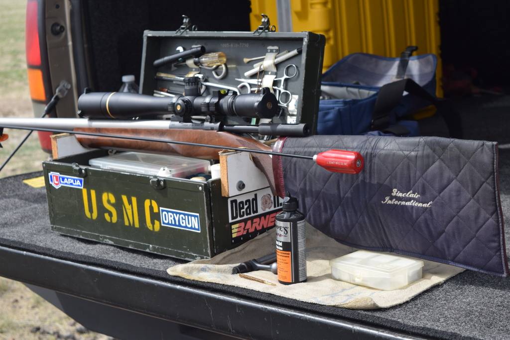

During our ground squirrel shoots, we just use the truck tailgate for a cleaning 'table', then grab a fresh rifle and continue. A Muzzle Mate keeps all the nasty from reaching the bed liner or Bed Rug, easy cleanup, keep shooting.

I did the tailgate thing one time. To much dust blowing around where I am at.
